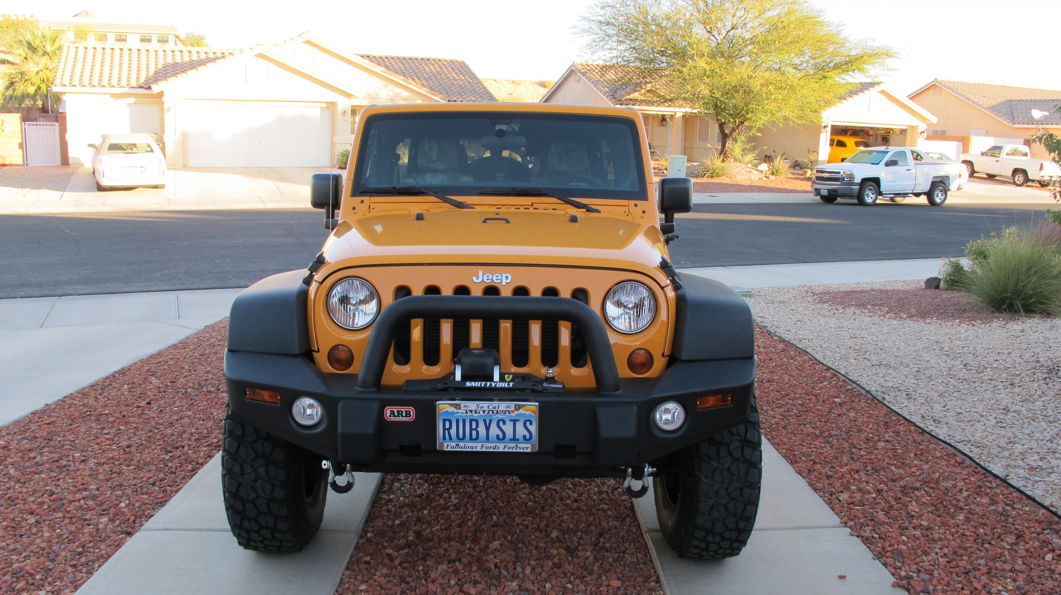

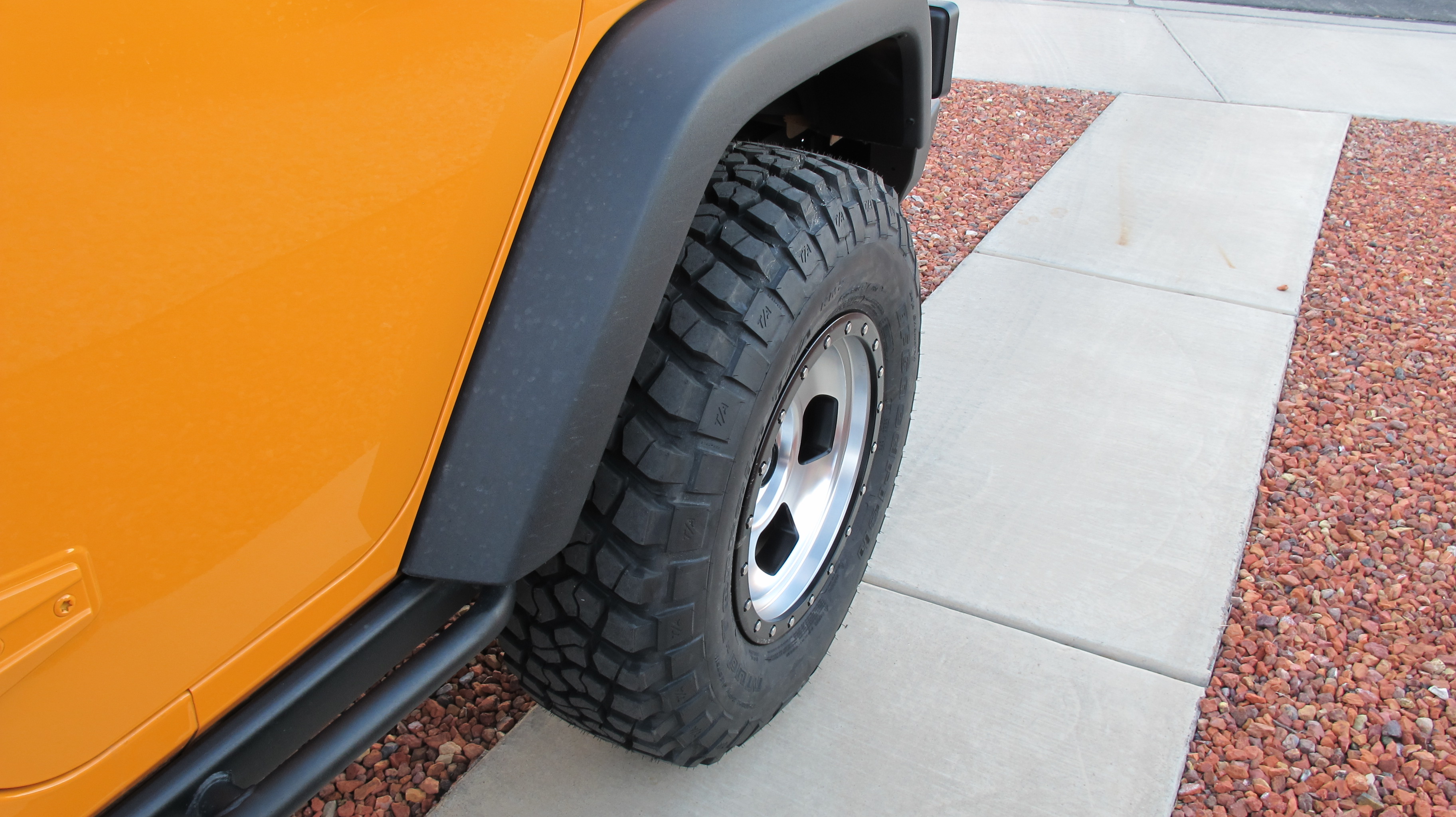

I don't like how far my tire is out beyond the flares with my 285/75R17 BFG MT KM2s and 9" wheels with 4.5" backspacing. If I drive on a wet street I get dirty water splashes on the doors. And there's hardly any sidewall bulge to help protect the rims.
When I ordered the work done we talked about 8.5" rims. If I had it to do over again with this tire size I'd go to 8" rims and maybe 5" backspacing.
You really need to give a lot of thought to wheel size and backspacing for your particular tire size.
