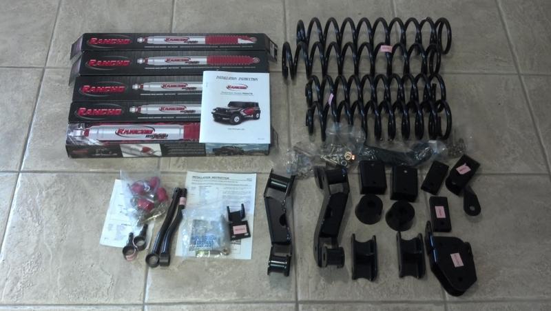

If it comes with adjustable control arms the Zone 4" can be set so the caster is OK while the pinion angle is still acceptable. I have the 4" Rancho Sport Lift on my 2010 JKUS that came with the control arm compensation brackets. Have not had any issues with drive shafts.

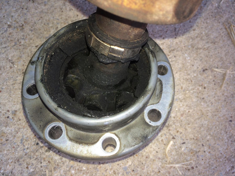

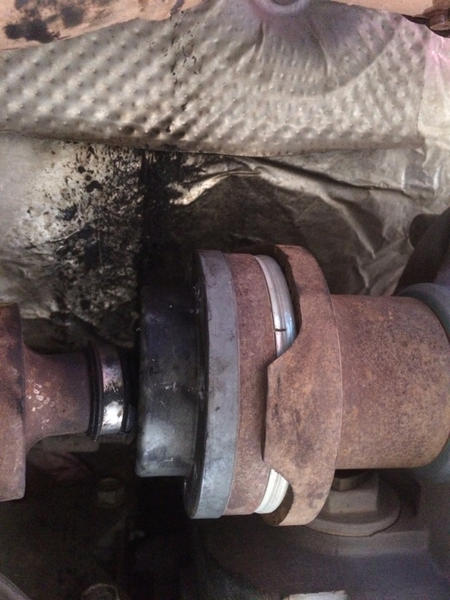

It's not a question of "will" but "when." You WILL tear the boot on the transfercase side of the front driveshaft, whether you are a pavement pounder or like me, after one Offroad trip and ~9 to 12 months of pavement pounding: Click image for larger version

At lifts 3"+ it WILL happen. Sent from some string and a few tin cans.

And it won't take much for the drive shaft boot to come in contact with your y-pipe crossover. You should consider exhaust spacers. They do reduce clearance but since you don't offroad it shouldn't be a concern.
