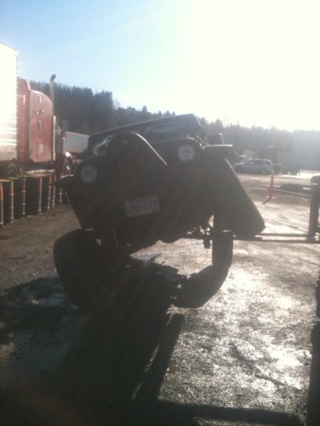

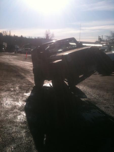

X2 when I did mine the pitman ATM was the worst part as like bcoop, I chose not to get the puller first. Now I own one though. Take your time doing it and have fun, post some pics after.
P.S Flex is great, on 37s ground to bottom of tire 40" with full disco and 3 tires touching.

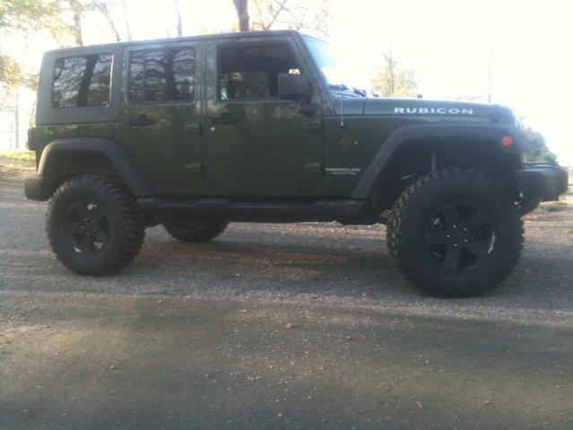

Here is mine with lift and tires. Picture doesn't really show height.
