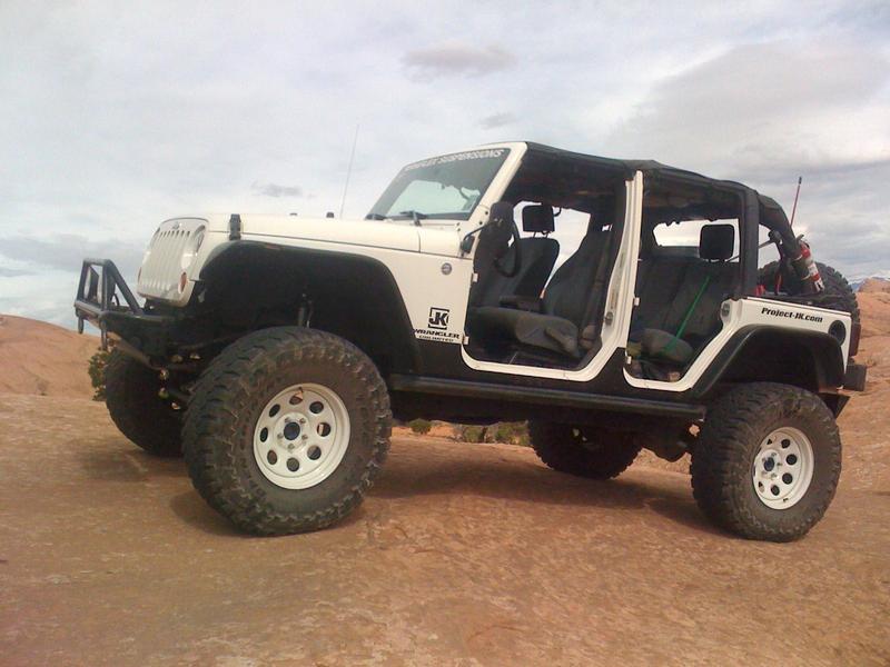

I would say my TF 4in shortarm runs pretty well on the street, it's my DD and I've driven back and forth to Moab on it with 37's. Handles well even with 40's.
37's...
