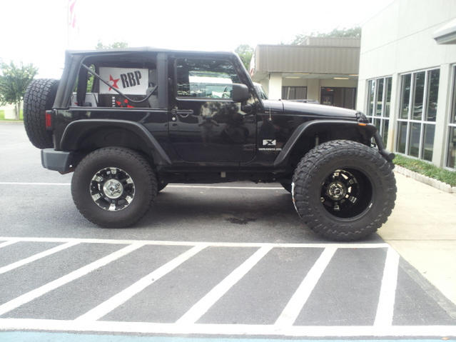

Well, I figured I would update this thread with what I decided on doing. Just dropped the rig off today to start the build. I went with a front PR 44 and 5.38 gears to push the 40's around. Added ARB lockers front and rear. here's a before and I'll post up some pics when everything is done. Thanks for the input!
Old Jun 13, 2012 | 07:04 PM
Boater's Avatar
Posts: 47
From: Destin, FL
Opps, here are the before pics....
