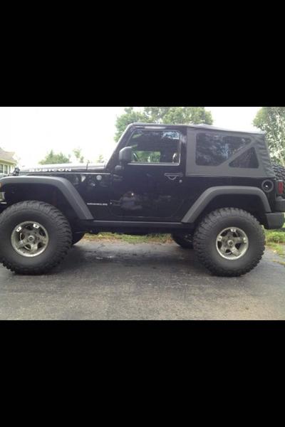

Why are you concerned with up travel ?
35's with 3.5"- 4" of height.

Up travel is a big part of rock crawling. So i dont want to hit and grind tires or fenders

2.5 and long travel shocks for down travel. Bumpstops will limit some up travel anyways.

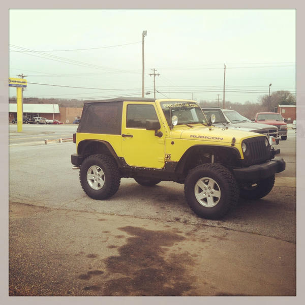

I have a rough country 4" lift running 35"s and I drive it everyday everywhere I go I get compliments but as far as off roasting the only thing I did was beat the pinch seem over its really close to the tire but of course I have the smittybilt fenders if you are running stock fenders you might want to trim them as we'll for max wheel articulation
