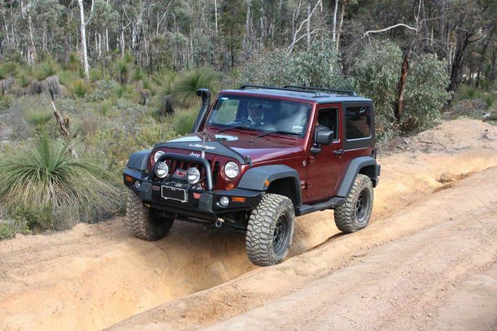

I'm running 285/75R16 on Procomp 16x8/5BS the flat tread is still in the guards but the tyre wall sticks out about 1.25".
No rubbing when disconnected front or rear when fully flexed. works fine. In fact there is just enough room to go 315/75R16, have a mate with the same set up as me but running the larger rubber with no probs...
