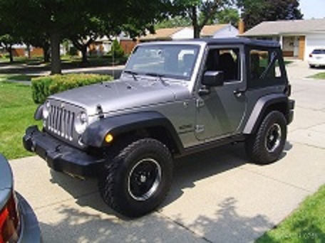

I have a 15, and run 5 in backspacing with 305/70/16 tires. I have no problems with them rubbing whatsoever. I don't offroad though so don't no how they would be when the suspension is flexed. Below is an easy converter for backspacing vs offset, hope it helps.

I have BlackClick image for larger version
ID:	604859rock Dune 941 16X8 wheels with a 5in BS and I believe 12 offset. You can look them up on the Blackrock website.

Originally Posted by Strider
I have BlackAttachment 604859rock Dune 941 16X8 wheels with a 5in BS and I believe 12 offset. You can look them up on the Blackrock website.
Got it, thanks for the details!
