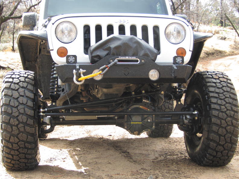

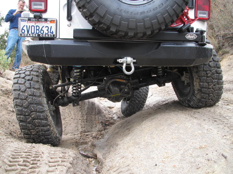

I went pr60's front and rear and love them. I feel like the extra width helps get back a lot of the stability the lift takes away. I'm running 37's with 5.13 gears, but will go to 38 or 39's on beadlocks in the future. Mine is a 2 door and I'm keeping the stock power, so I didn't feel the need to go full float in the rear. If I break a pr60 with only 285 HP, i did something stupid!
