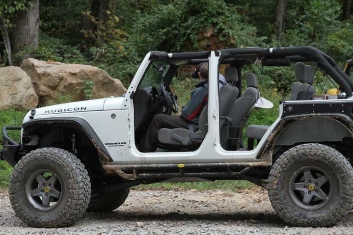

I am currently running the Procomp 6in long arm kit with FOX shocks and have nothing bad at all to say about it! Drives great on the street and kills it on the trails. I would say if you are going to wheel your jeep regularly I would invest in a PCS hydro assist steering kit. It was a must for me at least and has made life great while off road on my 37's. but before I went to hydro assist I had a FOX SS and that worked great also. I have added a lot of weight with front and rear bumpers, winch and poison spyder crusher fenders and corner guards also so im sure I am no longer at 6in lift anymore anyways. Click image for larger version
