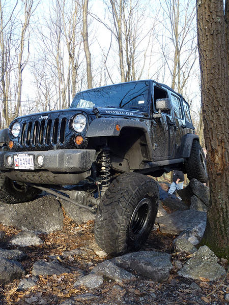

I run a 6" Teraflex LCG long arm and 37's with stock fenders and have no problems with rubbing or small looking tires. The flat fenders with 6" of lift will make 37's look small, think roller skates, and are not needed. With the Teraflex lift the ride and road manners are great as well as the off road flexing. This is a picture of 37's stuffed into the rear wells with no contact and almost full droop on the front with no rubbing.

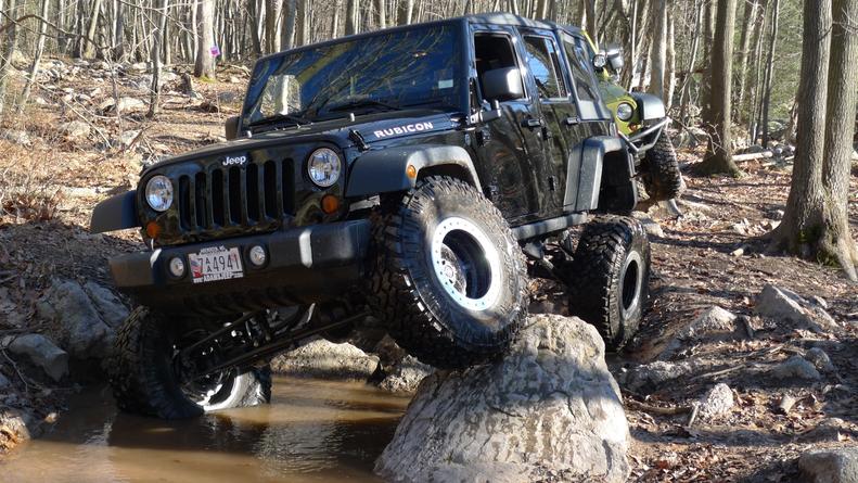

Here is the other way around.

I can also tell you that this is by far the best lift I have ever had to date, I have had quite a few on different JK's, and the most complete if ordered correctly. Good luck.
