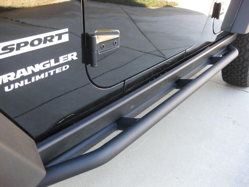

If there's 'give' then they probably need to be tightened. Zero give on mine, they feel like they're part of the vehicle.
I have the 4 door with Ace Rails + Rubi rails. I also weigh 200 lbs and stand on them all the time to take the top off, get in, etc. They really help as a step, especially if you have a lift.
I've beaten them on the rocks off road, they take a beating. I've landed on them HARD a few times and have had no damage other than some scratches. No dents or anything else though.
