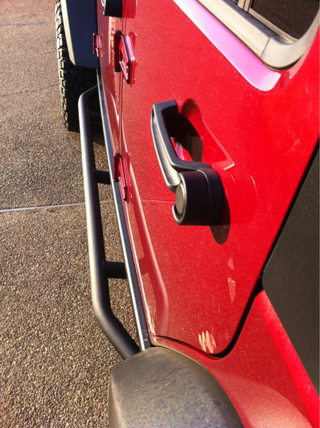

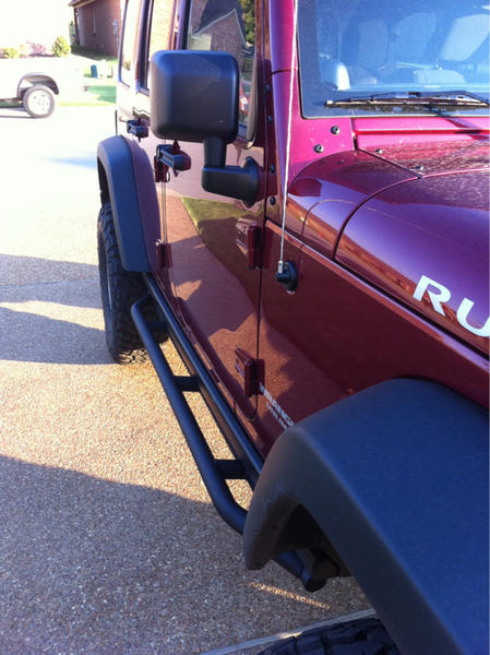

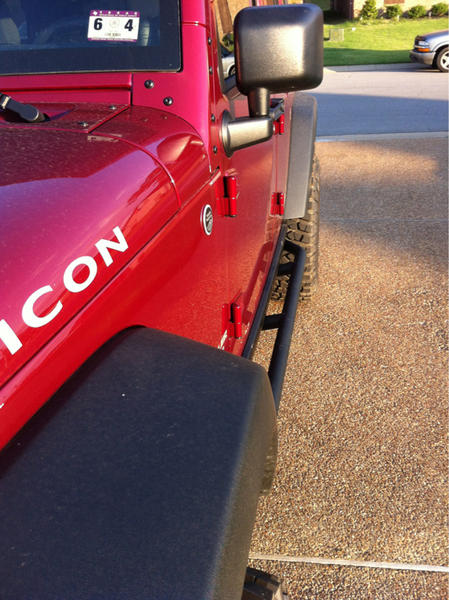

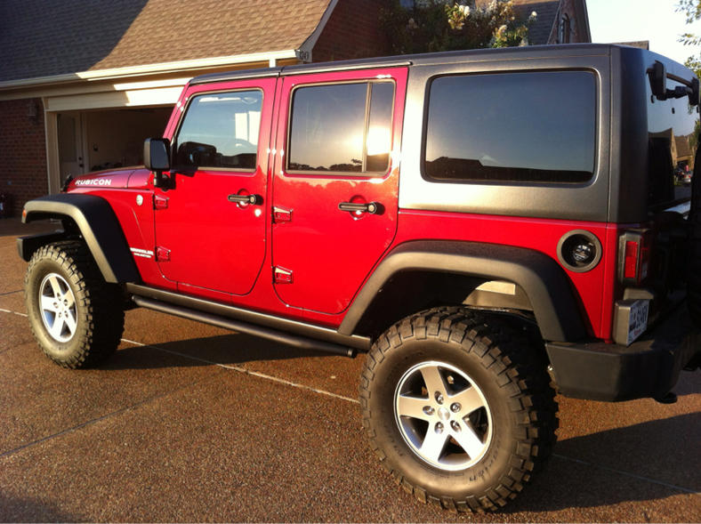

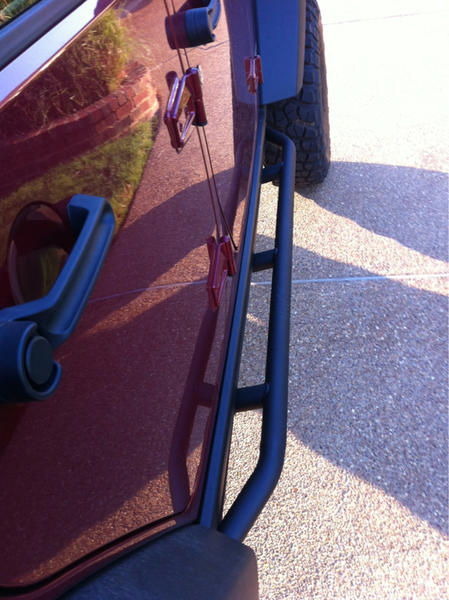

I agree took about 40 minutes and 2 people for the lifting. Awesome rails and not that expensive. I kept the stock rubi rails and love the look. Here are some pics.
