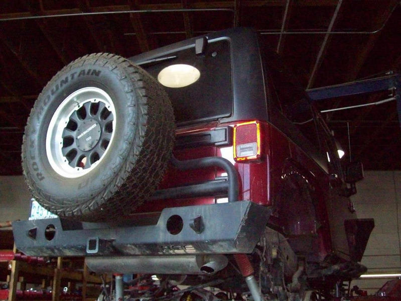

I don't really have any good shots of it and I actually just got a replacement carrier so it looks a little different. The new version has gussets on the vertical sides.
Here's what it looks like getting regeared

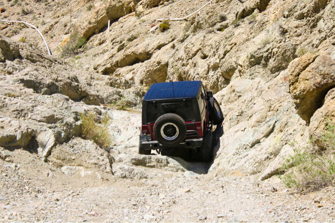

In the dunes

They solved the rust issue and have a new gusset system for the carrier. Their customer service is great and the price matches most bumpers before you add a carrier. The downside is the weight but if you want a solid bumper you have to accept that 1/4" steel is heavier than 3/16". It's a deep bumper and it takes more hits but I've smashed it numerous times and only scraped powder coat. Last weekend I took the JK vertical and the bumper stopped me from a possible flop a when it dug in to the dirt.
It doesn't rattle, it ties into the rear gate so you open with one motion instead of the carrier then the gate. It mounts easy without drilling holes into the body.
If you have money to burn there are other options but for the price I haven't seen anything close.
