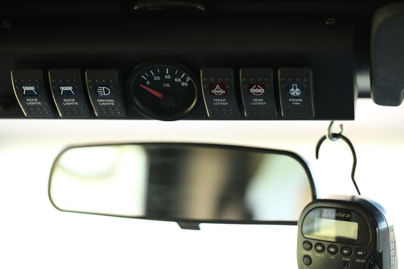

I am adding Front/Rear Lockers to my 2011 Unlimited Sport. My question is: Does the Sport Model have the Front/Rear Locker engage icons on the instrument cluster? If so, is there a way to utilize them, ie: Locker dash icon on when locker is engaged. I hope what I'm asking makes sense and thank you in advance.
Old Jan 3, 2014 | 05:07 AM
Mark Doiron's Avatar
Posts: 14,800
Likes: 374
From: Midwest City, OK
I've not seen where someone has done that. But, there is an active thread in the electrical forum where a fellow has hacked the CAN bus to make certain things work. So, even if no one has done it before, wouldn't be surprised if someone does in the future. Meanwhile, you might check out OTRATTW.com. They sell switches engraved/silkscreened with a variety of functions, including lockers.

Originally Posted by Benm1020
Sounds like to much to mess with just to get the lights lit up. Just have days that switched above and it will be easier
Was on phone before--now can show you the OTRATTW stuff ...
Name:	Jeep Work, Sep 13, 5_9826, Engine Fan Switch.jpg
There are threads on various ways to light these up, including wiring them into the dash dimmer control. There are two styles of switches, Contura II (above) and V (which are sleeker looking and better fit the new interior). Contura II are silkscreened, therefore when lit don't have the indicia glowing. The V are laser-engraved and glow quite nicely. Folks have mounted these switches in various devices, including the sPOD (above), Daystar center console panel, Rugged Ridge pillar pod, etc. If you're looking for a professional looking install, this is a very nice solution.

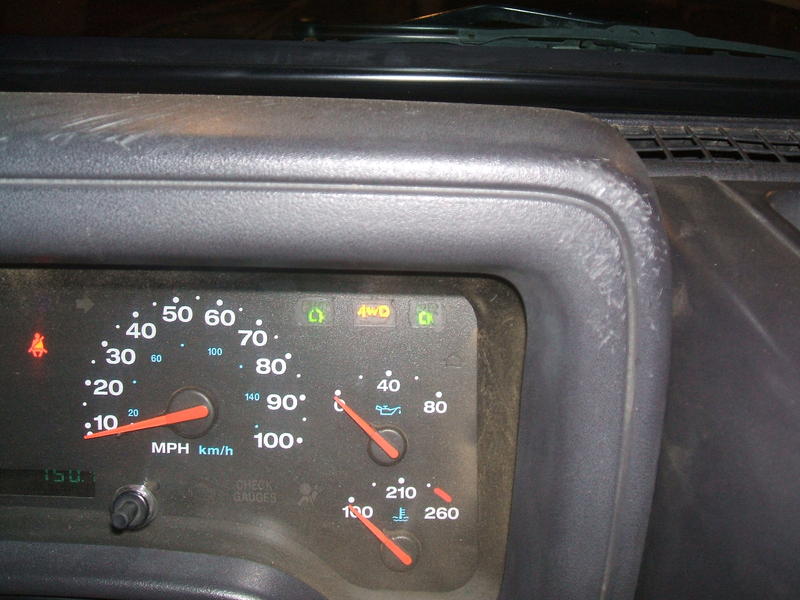

Old Jan 3, 2014 | 07:54 PM
BADDANDY's Avatar
Posts: 211
From: Spanaway WA
I had done this on my old TJ, but this is how I did it on my JK. The green light dash/red light JK switch comes on when the internal positive locked contacts in the locker close.
Attachment 521091
Attachment 521092
Attachment 521093
