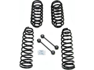

ID:	379894Click image for larger version
Below are some items that you will need as you start combining the two lifts together:
Adjustable front track bar (already have)
Rear track bar relocation bracket or rear adjustable track bar
Longer sway bar links for front & rear
Front lower adjustable control arms (already have)
Longer shocks
Longer front brake lines
Rear brake line extension bracket
Depending if you have bad bump steer / issues you may need to get a drag link flip kit.
....Courtsm3.....it is possible to combine the two lifts because the BB are spacers while the Performance lift are springs......
