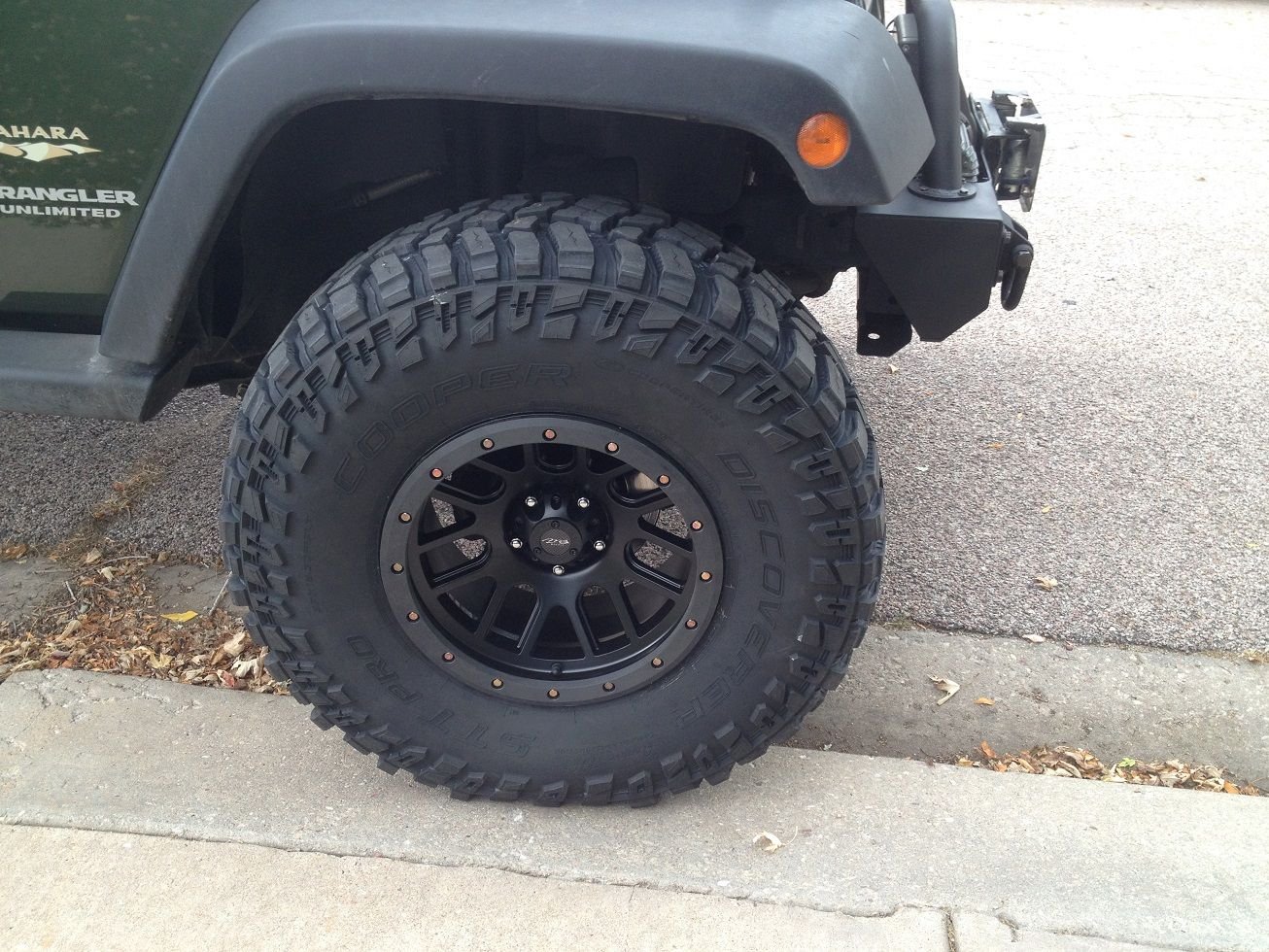

Just to add a visual, this is MC 3.5 and 37" stt pro's, before I got around chopping this set of stock fenders. I keep thinking about dropping to their 2.5"...
