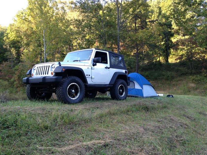

I put a Rough Country 3.5" series II on about 2 months ago and so far I love it. The Jeep is my DD and I prefer the ride over the stock suspension. I ran a set of 285/70/17's for a week and they didn't look terrible, but the 35's look a lot better. I still have the 3.21 gears and a 6 speed so it is a little sluggish, but not unbearable. I do plan to regear when I get the funds though

I put a Rough Country 3.5" series II on about 2 months ago and so far I love it. The Jeep is my DD and I prefer the ride over the stock suspension. I ran a set of 285/70/17's for a week and they didn't look terrible, but the 35's look a lot better. I still have the 3.21 gears and a 6 speed so it is a little sluggish, but not unbearable. I do plan to regear when I get the funds though<img src="https://www.jk-forum.com/forums/attachment.php?attachmentid=372803"/>
