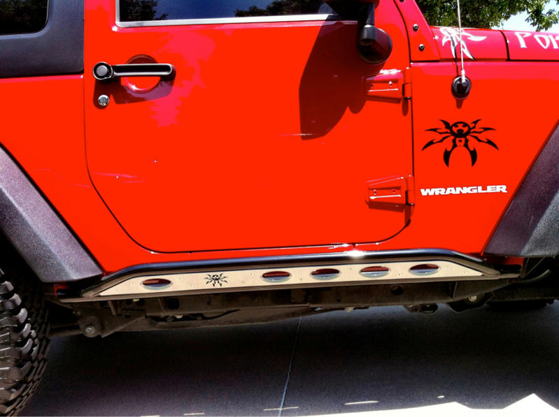

Old Jun 7, 2012 | 04:07 AM
hskr's Avatar
Posts: 82
From: Lincoln ,Nebraska
Love my PS rocker knockers.
