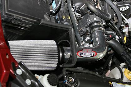

Just completed this install on Friday night. Total time (including a few beers): 50 minutes.
Comments: The intake pipe / heat sheild connection could have been a little better designed. The rubber gasket above the heat sheild is a little weak. Becareful removing the air sensor from the OEM rubber pipe (don't try pulling it out.. it will break... use a blade to cut the rubber and it comes out easily).
