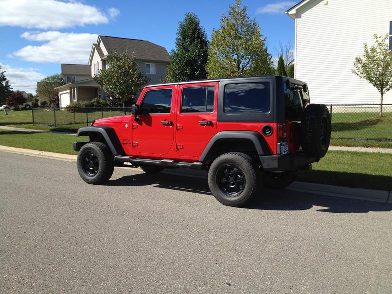

Finally got it all installed. Thanks for all the encouragement and tips you guys! It really helped. Just like you guys mentioned, got stuck on track bar reinstall and dropping axle far enough to put the new spring. Pure muscle (no pwr tool), few trips to Harbor Frights in the middle and finally after about 20hrs, its all done. now it looks like, I need a bigger tires, lol!
