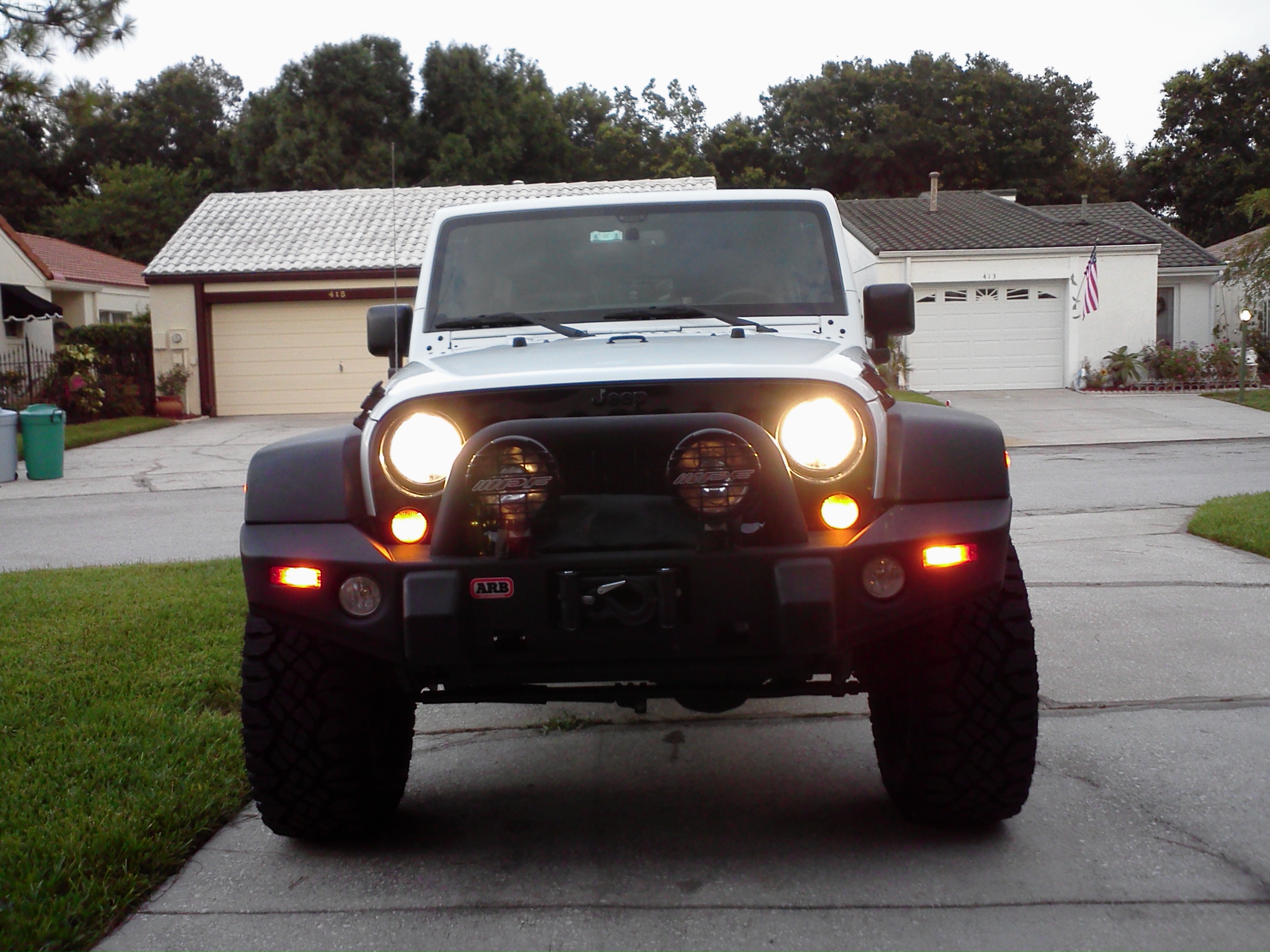

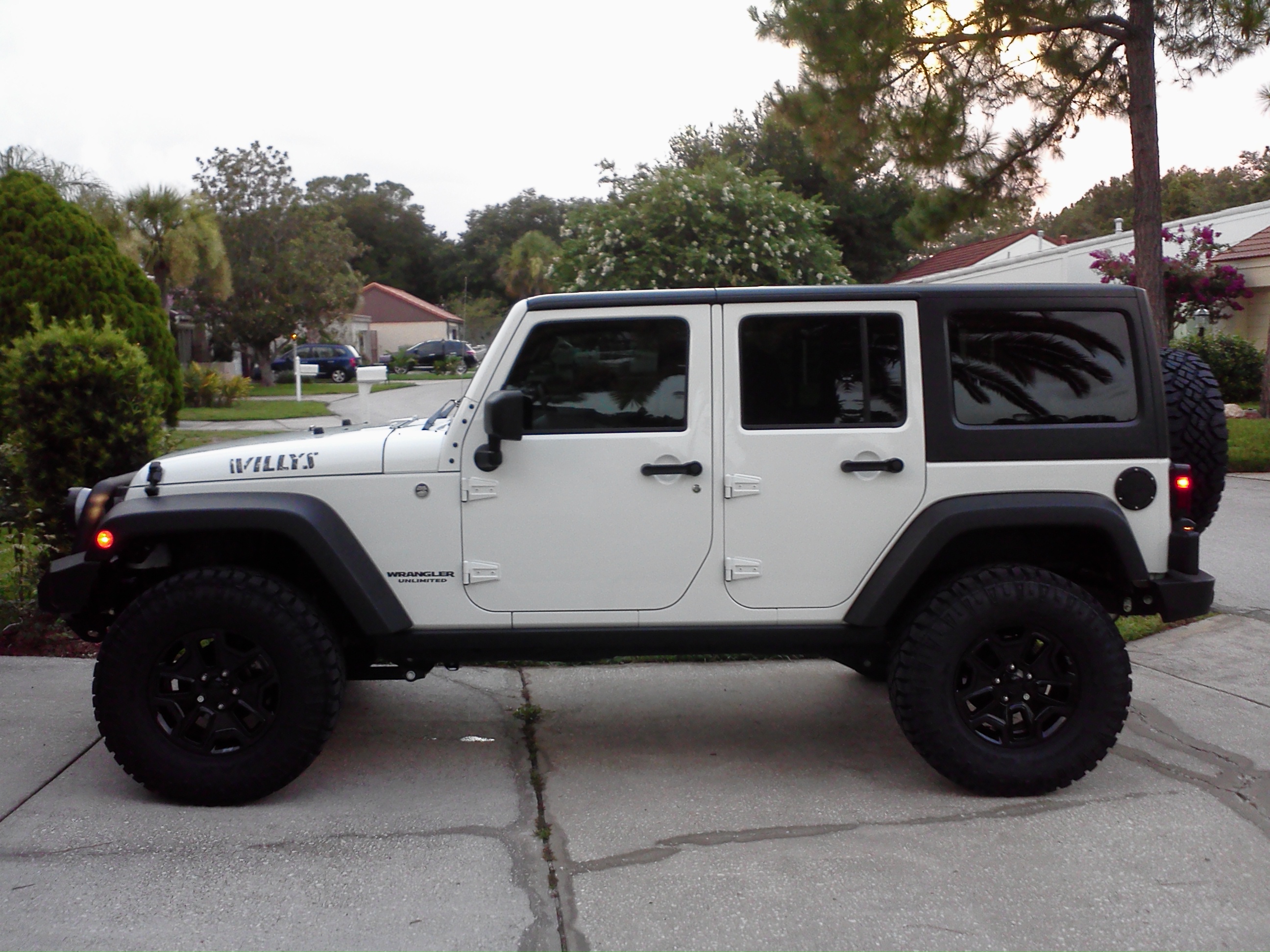

I just install the AEV 2.5" DualSport XT Suspension with AEV Geometry Correction Front Control Arm Drop Brackets on a 2014 JKU over the 4th of July weekend.
Will need the following:
Impact Gun (Air, Cordless, or Electric).
Sockets and wrenches - 10mm, 14mm, 15mm, 17mm, 18mm, 19mm, 21mm, and 22mm.
Drill with 3/8" and 1/2" metal bits.
Torque Wrench - 125 ft. lbs (minimum).
Visegrip to remove the front lower brake arm brackets.
Dremel with cutting bit or something similar to cut the front passenger plastic inside wheel well to install bolt/metal washer/bushing on top of the new Bilstein shock. Driver side will NOT need to be cut.
Will need too purchase Blue Locitite to reinstall the front driveshaft.
Will need too purchase Red Locitite to install AEV Geometry Correction Front Control Arm Drop Brackets.
