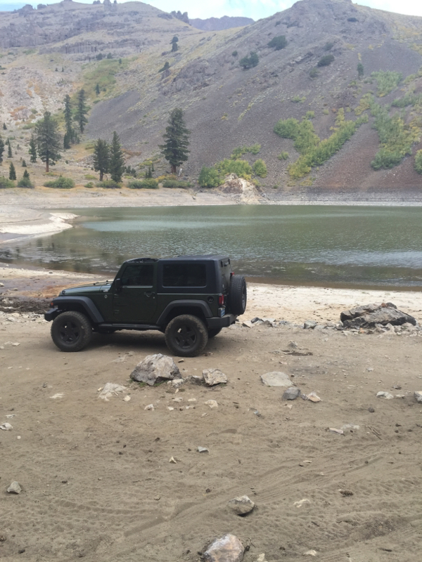

Looks good!!! This is mine with same size lift
