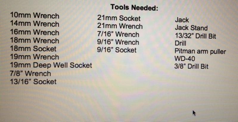

Is it true that some people have had trouble with the control arms sliding into the bracket holes? I read somewhere that you had to kick the tire into place or something.
Also... what should I torque everything to and what size sockets will I need?
Sorry for all the questions... this is my first real install by myself and I want to be prepared for everything haha
I used some chain & a come along to pull the axle while inserting the bolt(s)
It's not a difficult add-on at all
