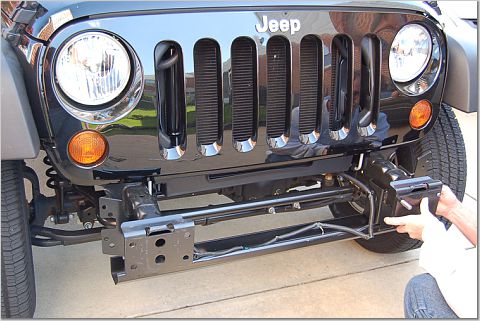

stock bumper removed.

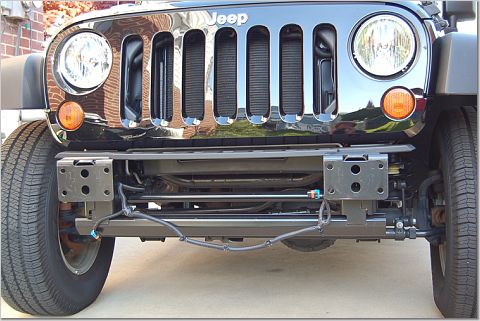

winchplate installed.

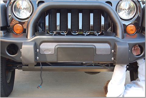

installing bumper. Here you can see the plate I made/mounted into the bumper.

bumper installed.

There was a few more things I had to do, like cut the crushcans off the stock bumper and install on the new winchplate. Mount the stock foglights into the AEV bumper. Glued the AEV Logo onto the bumper. And tightend everything up.

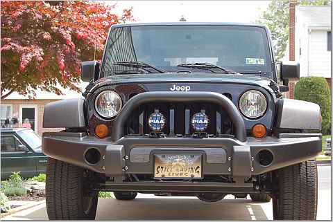

Here is a pic of mine without a winch:
