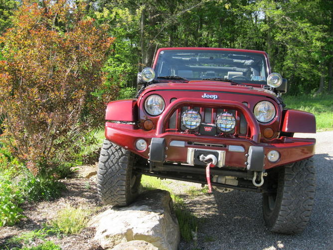

Have had both the front and rear bumpers for a little over two years now. I really like them both and would buy them again.
I like how wide the front bumper is, while still having a factory-ish look. It's saved my front fenders more than once going thru majorly off-cambered ruts by pushing the JK away from the rut wall enough to lessen the impact on the front fender. Most every other JK going thru the same ruts either entirely popped their front fender off, or majorly crushed it. For as much "side action" as my front bumper has taken, I'm impressed that the only thing I've had to do is just re-touch the paint. No dents or anything.
I also like how the winch is NOT mounted to the front fender. It mounts directly to the frame of the JK. The bumper isn't the lightest thing in the world, but I managed getting in on myself. No way in heck I could have done that if the winch was mounted to the fender, and I had lift them both up at the same time. I also like how the winch sits pretty low, no real impact to airflow through the front grills (although you have to make sure that the winch model you want fits).
The only thing that didn't totally impress me about the front bumper is the look of the weld lines. The main part of the bumper is machine pressed, which to me looks super clean. The top piece (that's to the sides of the winch) are hand-welded to the main part. On my bumper, it was a very heavy weld. Just didn't look as clean as the rest of the bumper. Don't even notice it now, but when unpacking it, I was one of those "hmmmmm" moments.

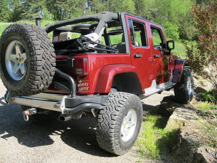

I ran the rear tire carrier for a few months with the stock bumper, so those were two separate installs for me. There's a bunch of steps for each, but I don't remember either one being particularly difficult. It's definitely not a "take the five bolts off the stock bumper, slide in the new number, put five bolts back in" install. If this is a concern for you, AEV's website has the full install instructions online that you can download now to look at.
I ran my tire carrier for a little over a year without any rattles. When it did start to rattle, I just had to turn the turnbuckle another turn, and it stopped. No squeaks/rattles since then. I also was surprised that they use washers to shim the turn buckle, but if the shim is going to be different per Jeep, I'm not sure of another method. Functionally, I've had no problems with it.
The water tanks that come with the bumpers are a bit of a PITA to use. I've never been able to get in the advertised 5 gallons, more like 3-4. But I've been on a few runs with my local Jeep club where someone's radiator has an issue (either low level from a crack or loose cap, or overheating from being covered in mud) where pulling a gallon or two of water from my rear bumper was easier/better/quicker than them running from Jeep to Jeep seeing who had extra water bottles with them.
I also like how the tire carrier attaches to the tailgate, and doesn't require an extra latches to open/close. You open the tailgate just like you normally would. No extra steps because of the tire carrier.
There are some other accessories for the tire carrier, like a 10 gallon fuel container, and a high-lift/pull pal mount. Neither are inexpensive, but the functionality of both are pretty cool, IMO. I ran my high-lift on it all of the time until recently, and never once heard it rattle.
Coming off of some ledges with big drops, I've slammed my JK down on both sides of the rear bumper a few times since I've had it. Got some scratches that painted out, but no dents/bends/needing to unbolt/realign anything to make it straight again.
My only "complaint" with the rear bumper/tire carrier would be the price. Who wouldn't want it for less? But functionality and durability wise, it's exceeded my expectations.
