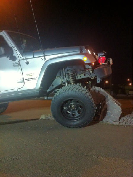

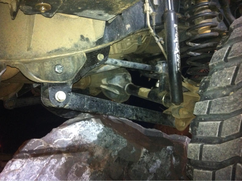

I would recommend them as well, I've been running the rough country version of this product for almost 2 years on my jeep. Recommend the AEV ones for the adjustment.
Nice ride improvement on road, and slowly all my friends are adding them to their jk's or the daily driver comfort.
