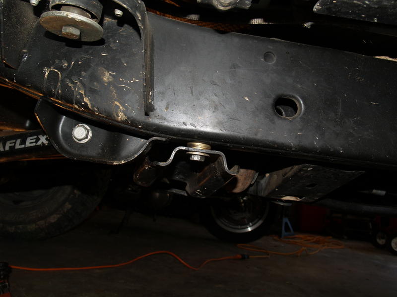

Old Mar 20, 2011 | 06:23 PM
nthinuf's Avatar
Posts: 11,463
Likes: 165
One thing not shown in the pic above is that he is also using a bunch of washers to lower the skid as well as notchng it.

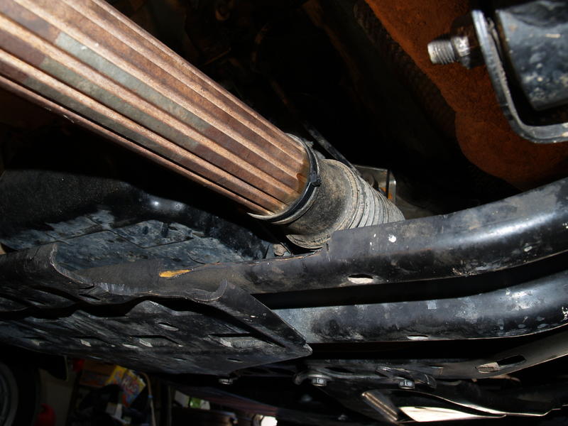

[attach=config]140169[/attach]
Originally Posted by nthinuf
one thing not shown in the pic above is that he is also using a bunch of washers to lower the skid as well as notchng it.
:d
Old Mar 20, 2011 | 06:57 PM
mkjeep's Avatar
Posts: 15,665
From: Hammond Louisiana
My pc was giving me probs and the info that was supposed to go with the pic got deleted. Basically what nthinuf said is all correct, you can make it last a little while but you'll eventually need a new aftermarket one.
