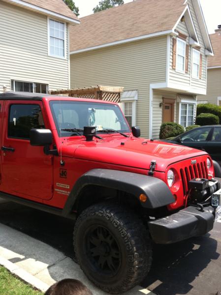

The ram air works very well in water. This is the configuration I use most of the time for DDing. The only issue I have with it here in Idaho is the dust. That's why I also bought the Donaldson topspin H002437. The same company who makes the precleaner for AEV, but this one doesn't look like a fish bowl. It also cleans itself where as the bowl needs to be cleaned once in awhile. A little bit of AEV paint to cover the lettering and it looks very good.
