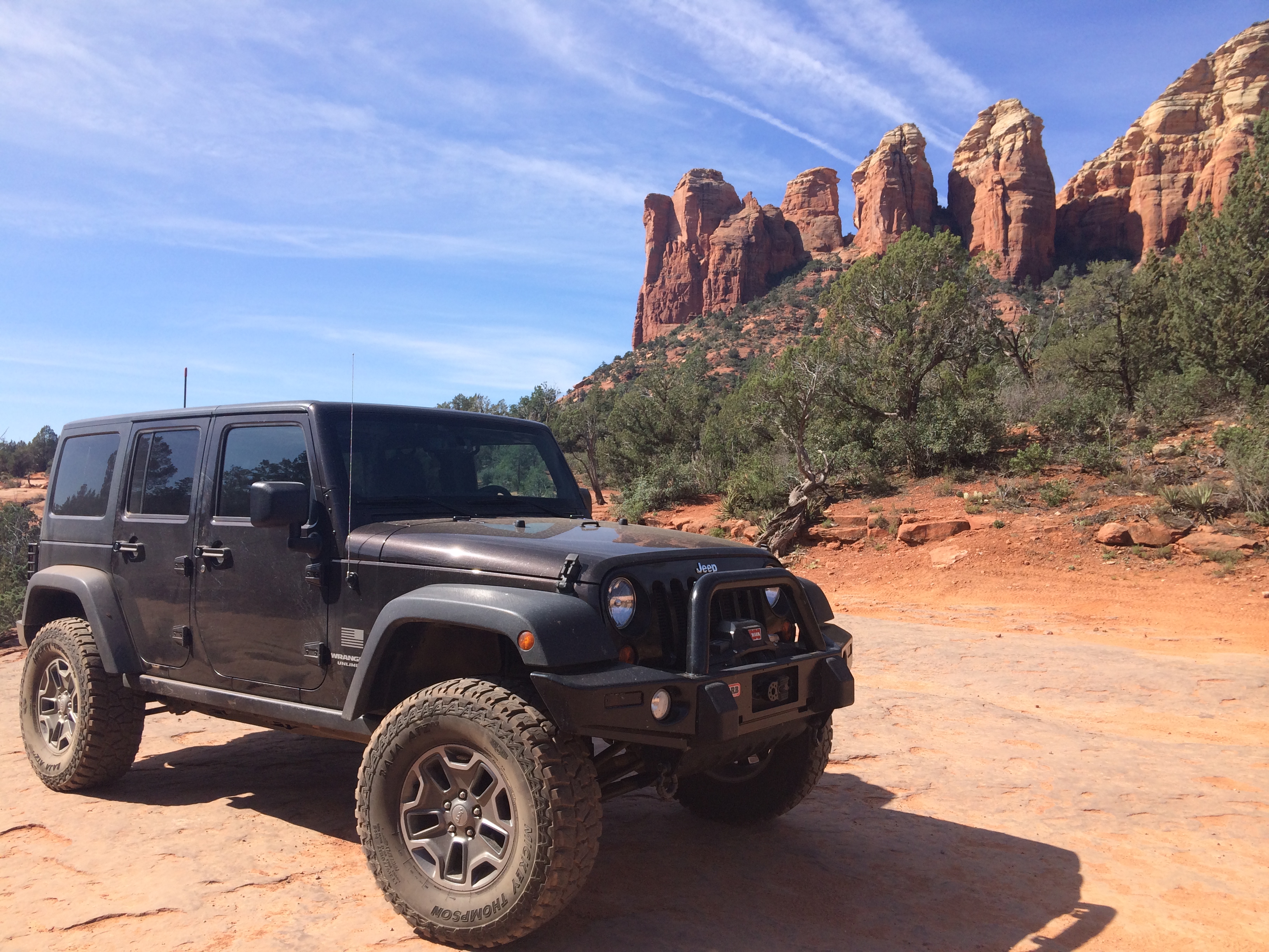

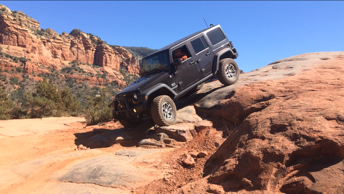

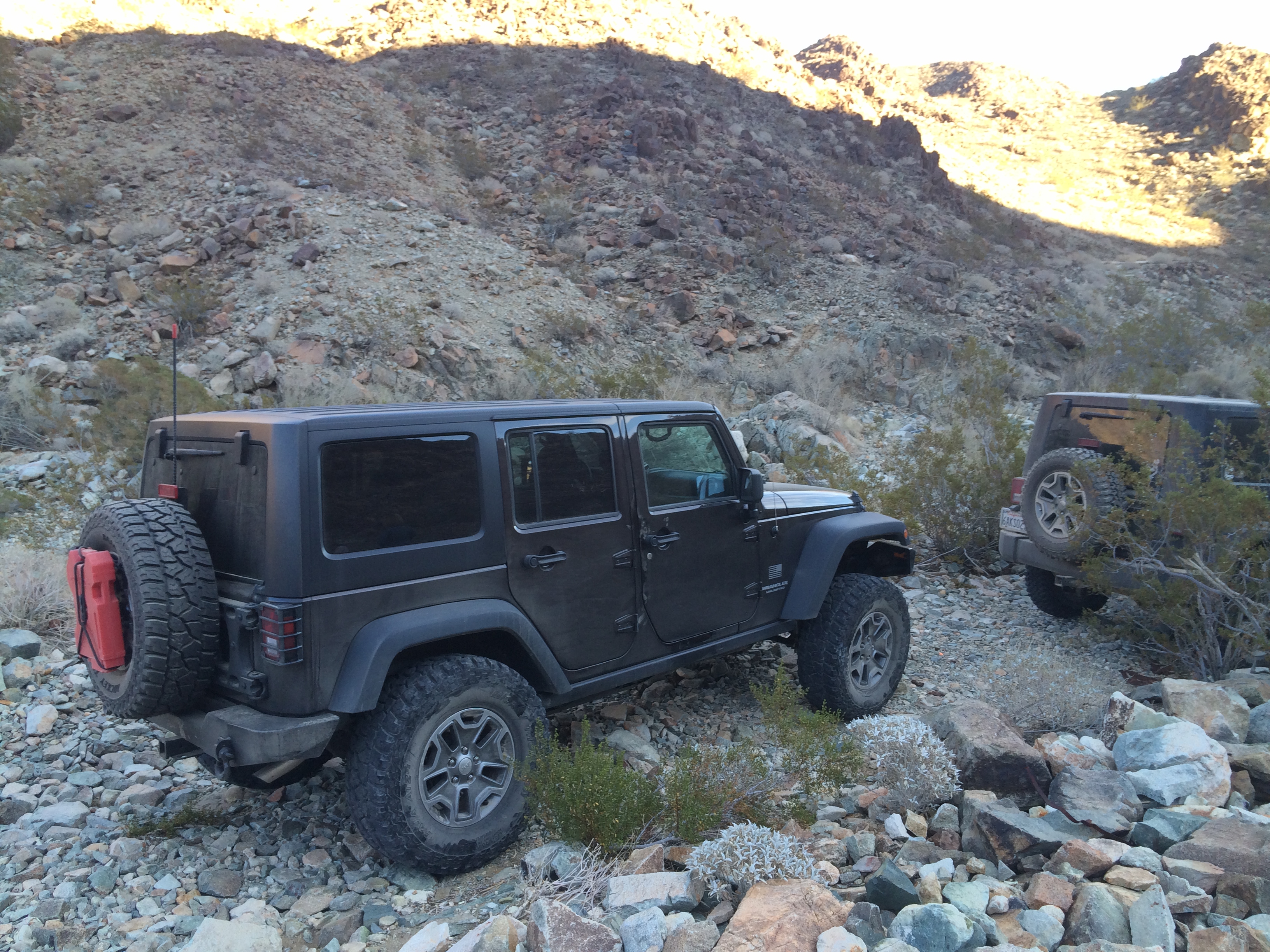

If you are going to use your Jeep hard off road and load it down with heavy bumpers and armor go with the RK product line. AEV products are good and ride nice on road, but RK at least out west in our deserts and rocky terrain holds up to the abuse of being banged around a lot better.
I run a JKU with a 2.5" (3" actual height) RK system with 35" Mickey Thompson ATZ P3 tires, heavy ARB front and rear bumpers, Warn Zeon winch and a bunch of underside armor. The RK springs with their heavy rates have not sagged even after 39K miles of hard use.
Your choice of the ATZ P3 is excellent. They are built on the well proven nearly bomb proof carcass of the MTZ M/T tire. There are other hybrid AT/MT type tires out there like it but none have the lineage of the ATZ P3. Mine have proven crazy strong with grip like those found on the proverbial Mach 5 running it's grip tires. All that said it may be to much tire for your needs and wheeling terrain. I would point you to also look at BFG KO2 tires. They are not as aggressive off road as the ATZ P3 but ride super smooth and handle the foul weather of the Atlantic costal US superbly.
