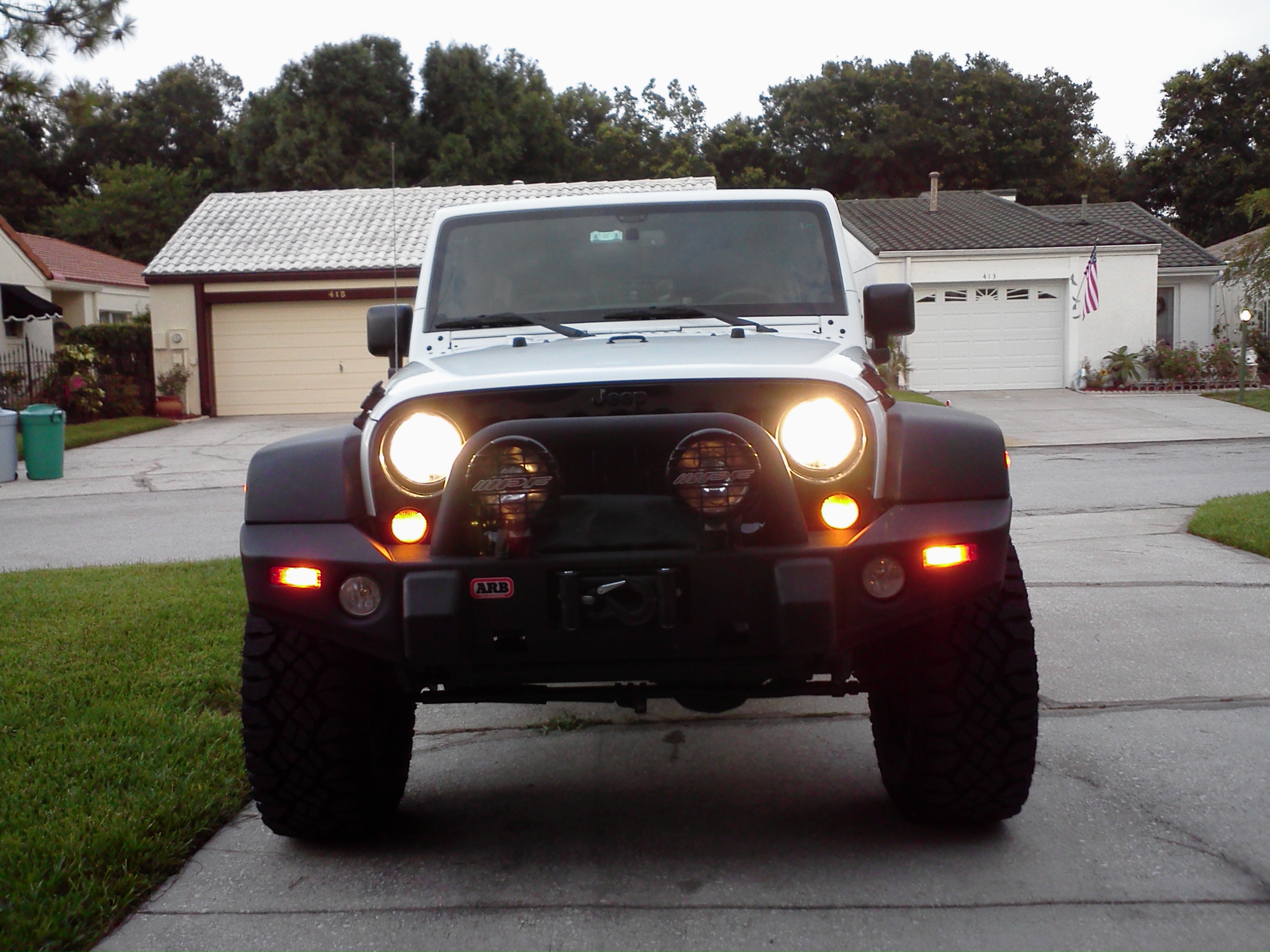

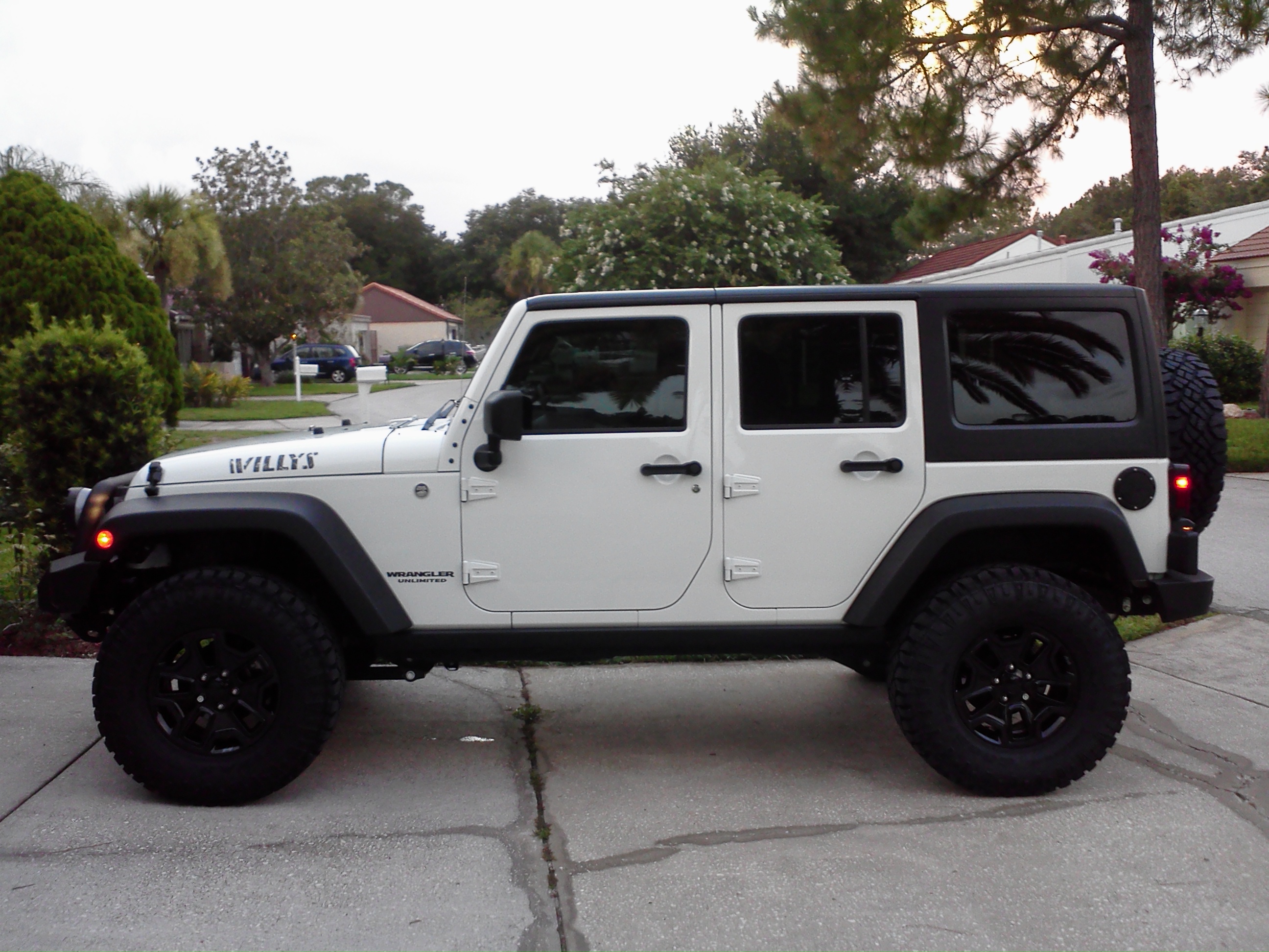

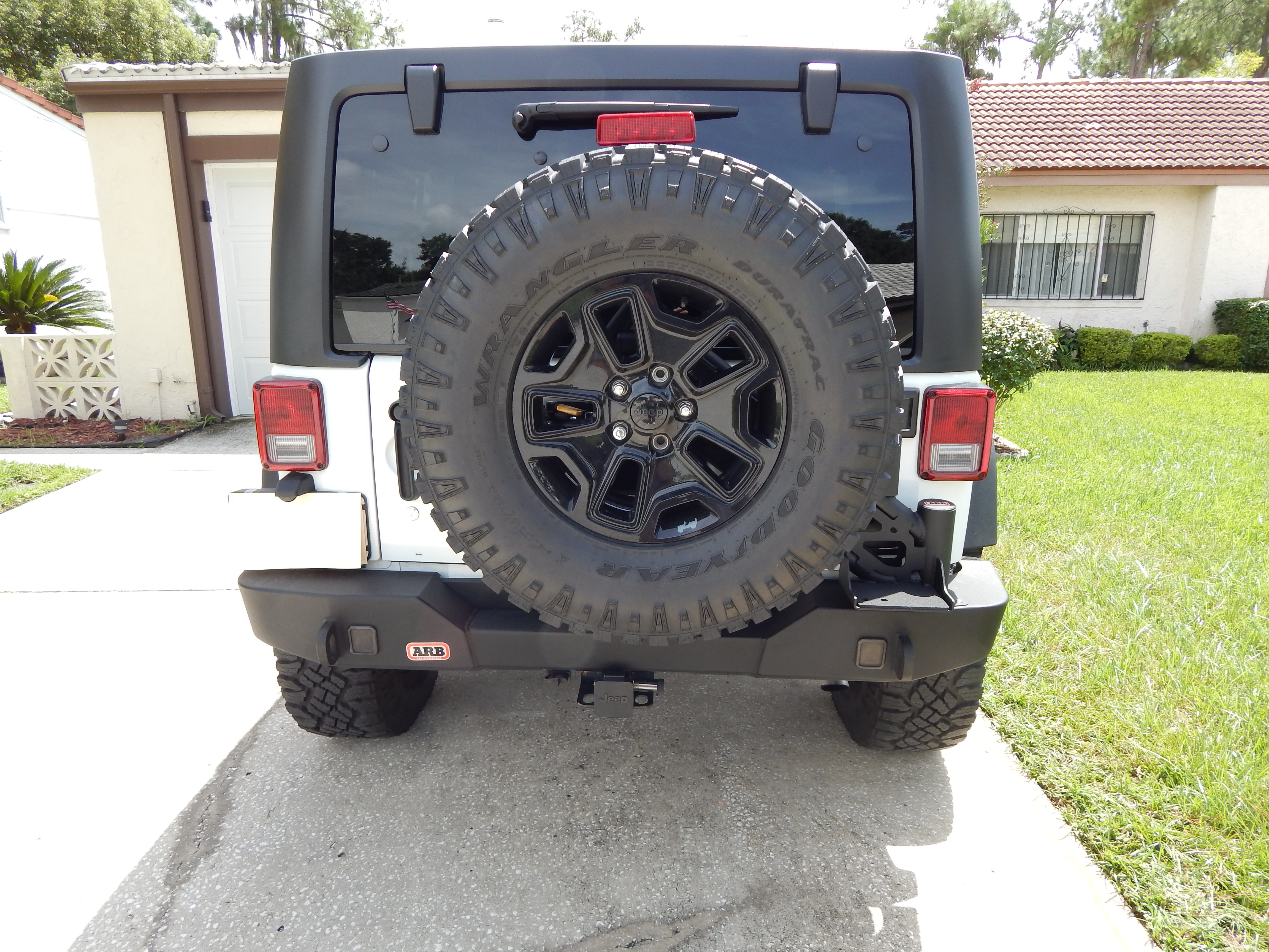

Really depends on how you are going to equip your JKU. Both RK and AEV make good Suspension Kits. The first of July I installed the AEV 2.5" DualSport XT Suspension with AEV Geometry Correction Front Control Arm Drop Brackets and Spidertrax Black 1.5” Spacers with Factory Willys Wheeler 17” Wheels and Goodyear Wrangler DuraTrac 315/70/R17 Tires. The main reason I selected AEV over any other Suspension Kits is because of the heavy bumpers I installed on my JKU. I have ARB Deluxe Front Bull Bumper and Smittybilt X2O-10K Waterproof Synthetic Rope Winch which weigh over 180lbs. The rear I have ARB Rear Bumper with Tire Carrier and tire/wheel and weigh over 195lbs. I use my JKU as a DD and driven over 3000 miles and the AEV Suspension and Goodyear tires handles and rides great. You may want to watch YouTube Video on how JKU handles with AEV 3.5 Lift and 35s on a road track - https://youtu.be/HbKniB2gkl8
