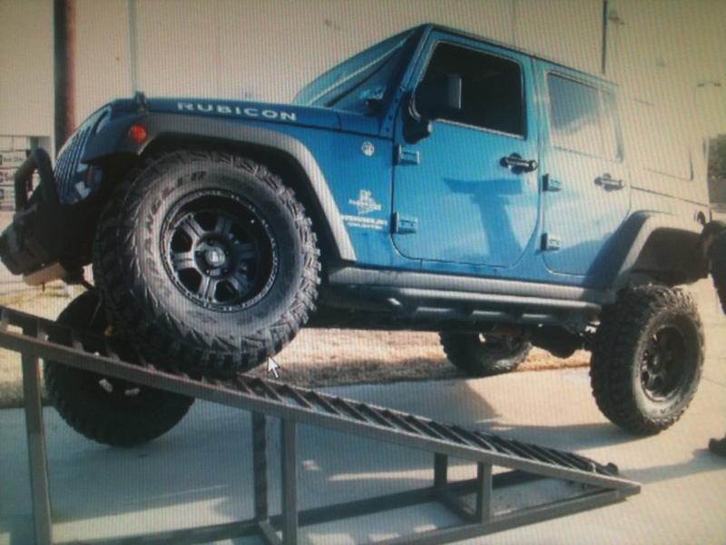

Whatever works for ya! I am happy with my AEV, just not the tire guys who installed my MTR tires inside out initially! My Jeep flexes pretty well.

Honestly, did you see my pics? My springs stuff very well and my ride is smooth; just sayin
