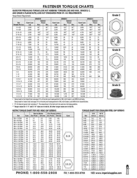

I just bought the new Rugged Ridge All-terrain bumper, I gonna install it this week-end, Just a quick question.
At which Lbs torque should tight all bolts and nuts ? Should I also use RED lockTite on bolts ?
I'll also install a winch on it, same question here, how tight should use to sit winch on winch plate ?
Thanks to help !
Old Jul 19, 2013 | 08:54 AM
OH9JK's Avatar
Posts: 3,796
From: Stokesdale, NC
Blue loctite not red.
Here is a torque chart. Just look up your bolt size.
