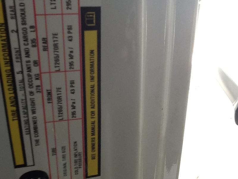

Thanks everyone, I aired them down to 30. it rides so much better. Now ingot pull out the AEV procal to reset the tire pressure. The computer has the warning light come on at 43lbs

On the 10 anniversary with km2 require 43lbs...
