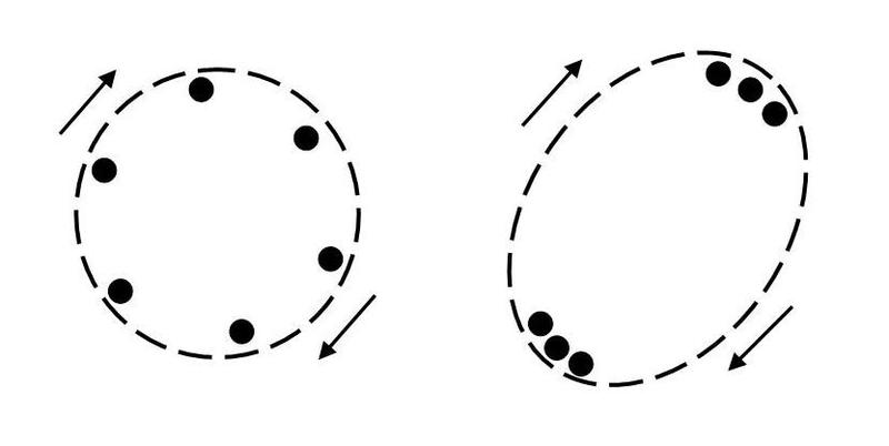

Originally Posted by olyelr
I have been reading about people balancing tires with beads for years now, and I still have yet to figure out exactly what the hell it is the beads actually due to balance a tire. I mean, weights placed in strategic areas I understand, but beads wobbling around inside a tire... how does it even work? Enlighten me!
When the tire is not balanced, it causes an elliptical movement -- that's what makes the vibration.
Centrifugal force pushes the pellets to the far end of the ellipse, which balances the tire.
When the tire is balanced, the rotation is circular, and the pellets spread evenly.
Name:	Pellet Balancing.jpg
I guess that there is rapid oscillation between balanced and not balanced.
It can't work at low speed when there isn't enough centrifugal force.
