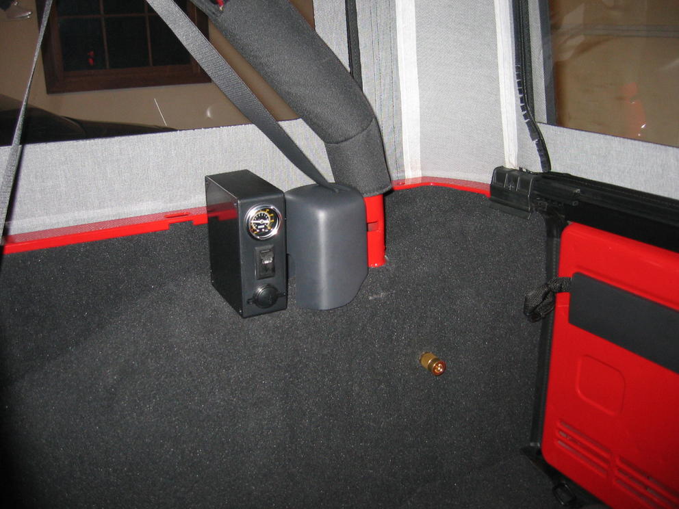

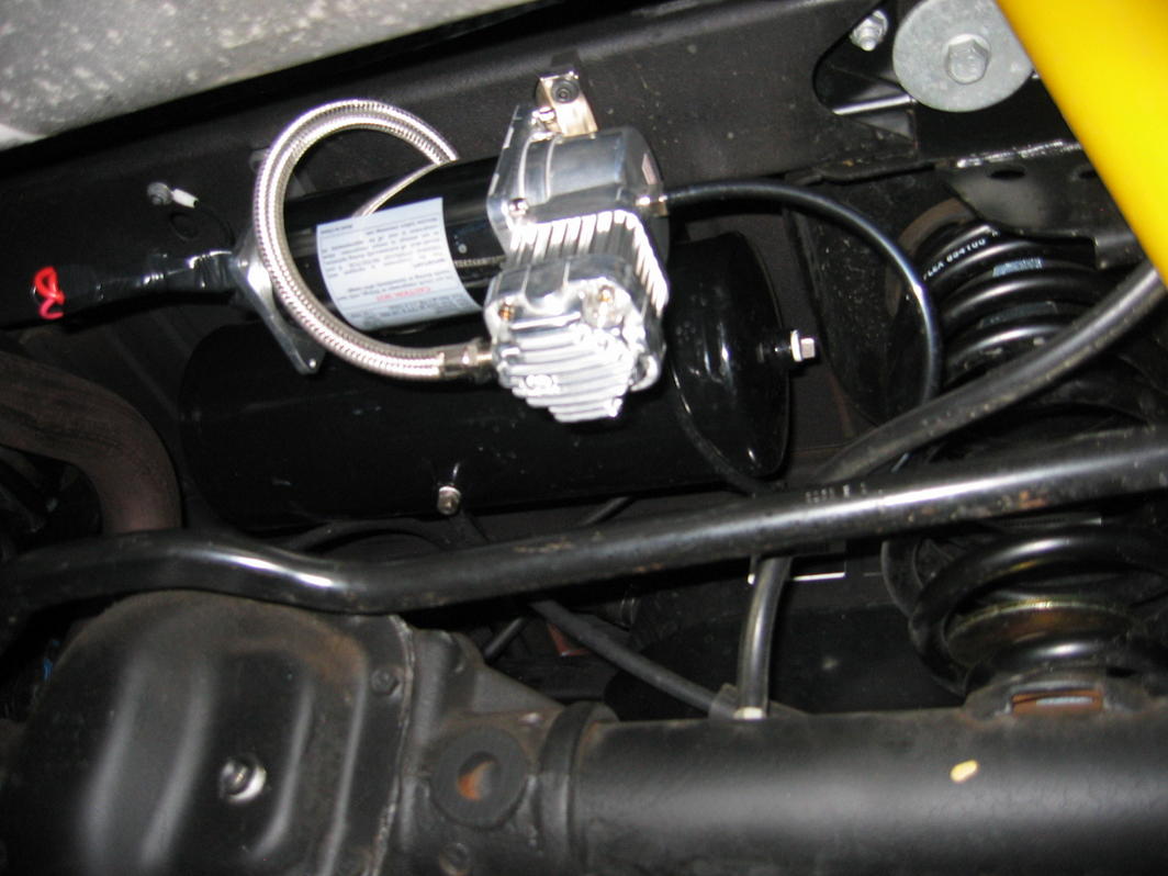

I mounted mine above the rear axle. Its a 2 gallon tank that I got from a website that deals in air horns. Cant remember the name right now; I paid about 50 bucks for the tank. See attached pics. Works perfectly with a Viair constant duty compressor; I have 150 psi when needed. Also built a custom control panel with power switch, pressure gauge, pressure switch (on at 110 off at 150) and a 12v power port.
