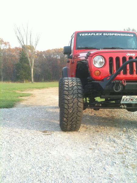

I believe I have bent c's? Look at my pic. You can see the front tire leaning. My steering wheel became off set after I went wheelin. Did I bend something else to?
It could be a worn out ball joint, worn out unit bearing or a bent C and/or axle tube. The bent C is most common.
Any way to bend it back and then gusset it?
I'm sure it would be possible but I don't think I would recommended it.
