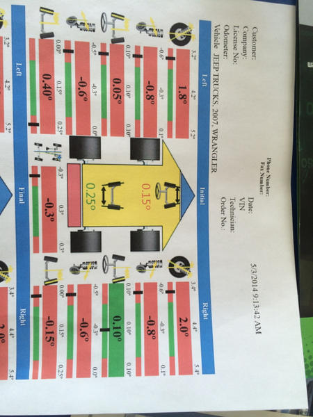

So, I drove my left front up a 3ft vertical cement wall at work. Because my coworkers said I couldn't lol. So here we are

Results from being a jackass. Minus caster and camber. Those have been off since the lift
