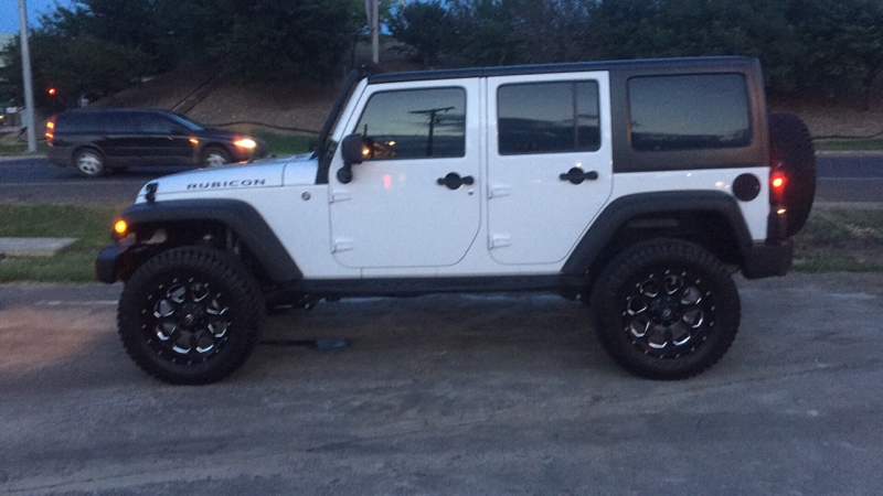

Have any pictures of the suspension as it sits?
