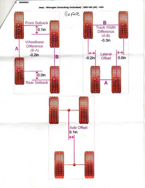

you should have gotten a report like this from a good shop:
