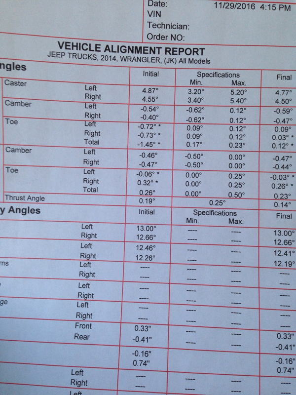

Do these numbers look good? Thanks in advance

Someone probably knows better than me, but those toe numbers don't make sense to me.
All else looks fine

Steering wheel is not center.

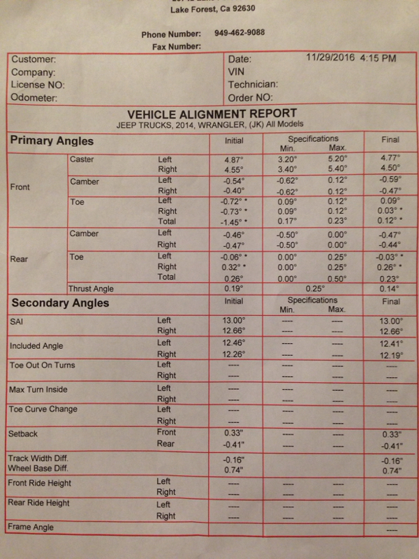

The jeep wanders when driving over 60. I have 3" TF w/flexarms. Bought TF steering kit, TF ball joints, TF SS and drives horribly at highway speeds. Spent 1k to make my jeep drive like shit. Hoping it is something with alignment. Anyone who can chime in with good info will be appreciated. I added an antirock recently so maybe also getting used to that? What are thoughts on toe? Click image for larger version

Your toe in front is way off , should be around 20-22 total

thanks. So tell them 10 on both sides. Will give that a shot.

you won't get both exact the same, that's just
Steering geo. But needs to be as close as possible

Rights theres no individual toe so if its different side to side the steering wheel is not center.

rebar you are the man. Thx. Shop adjusted to 21 (10 on right, 11 on left). No more wandering. Jeep drives perfect. 👍
