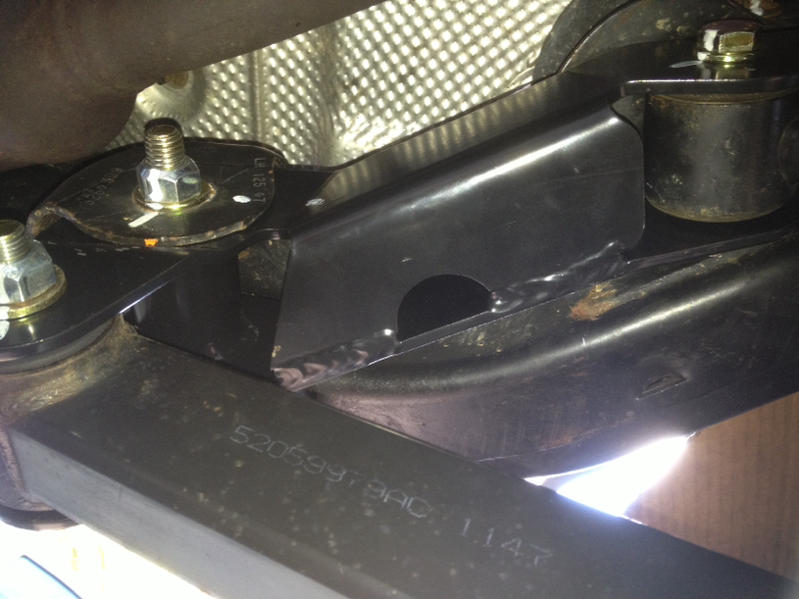

You using Rancho drop brackets?
Yes, I am using the Rancho drop brackets.
And still using stock control arms.
And no cam bolts/washers.
And caster is on the money.
And steering is solid at all speeds (haven't been over 80mph but 75 is good).
Rancho did their geometry homework and got it right.
The Rancho drop brackets are built as a welded, one-piece unit, unlike the competition's.
http://gorancho.com/assets/applicati...6250B_Sell.pdf

I know .....
