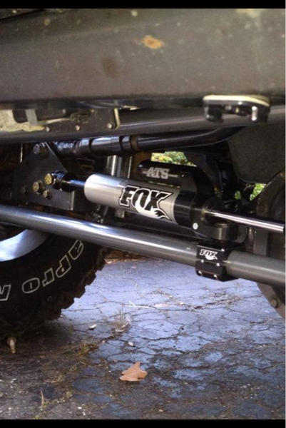

That person was me. Control arm drop brackets do wonders for drivability. (Leaving off road out of it) and put caster back into stock range. Nothing to adjust and the stock bushings are better then some aftermarket bushings out there. Caster in check, toe in 1/8 and steering centered is about it. Pretty easy to do yourself.
Next I would be looking at correcting steering geometry in the 4" range. Before installing me Synergy flip kit the steering wheel would jerk back and forth over every bump.
I see it a lot ... "4" lift for only $500"
Anybody can throw 4" coils in a kit. Maybe bumpstops/sway bar links and most likely cam bolts for caster. Lifting a Jk over 3" introduces a slew of problems if not set up correctly IMO.
There's also comes a point where it's impossible to run stock caster and have decent drivability
Try lifting the jeep 4" (5" front and 4" rear typically) and run 5* caster. The pinion angle becomes just too much for the DS Cv Joint to handle. Some folks have no choice but to give up caster for pinion angle.. Especially if the front DS was replaced.
