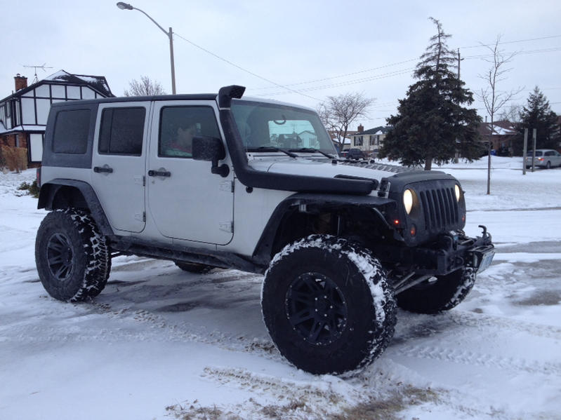

3" and flat fenders is PLENTY.....
ID:	527284Click image for larger version
ID:	527285Click image for larger version
