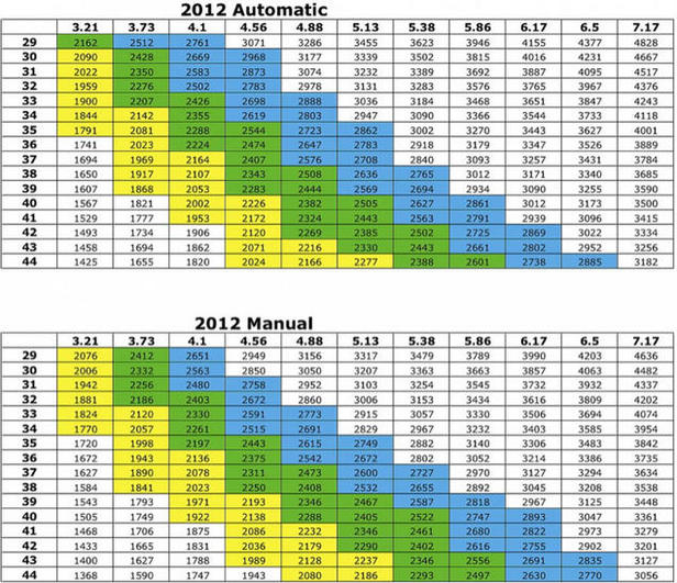

For DD and moderate trails, even with all the "irons" and full load, the 4.1 will give you plenty of power.
My heavily loaded JKU with 35"s, does hard trails with 4.1 and doesn't need more, so, for you, I think that raising the r.p.m. with 4.56, would be a waste of engine & fuel.
Name:	Gearing TABLE.jpg
My heavy Jeep with 35"s does hard trails with 4.1 and doesn't need more, so, for you, I think that raising the r.p.m. with 4.56, would be a waste of engine & fuel.
Attachment 578540
