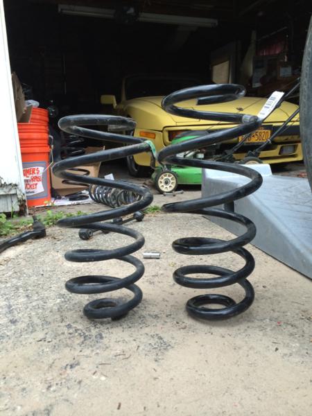

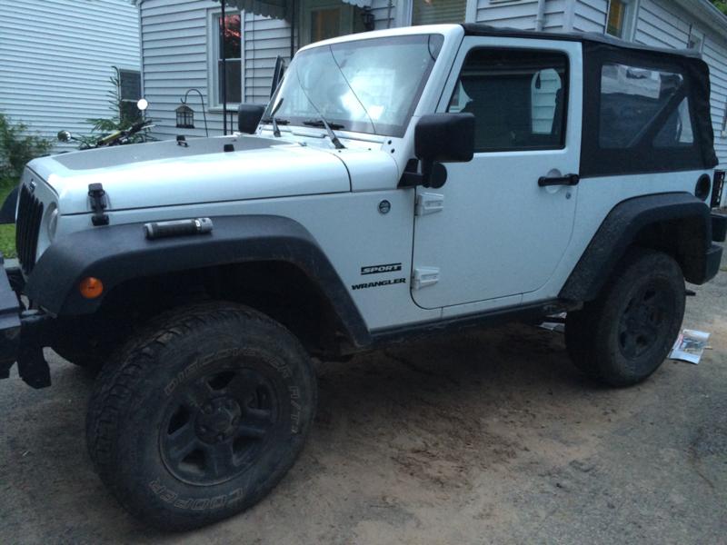

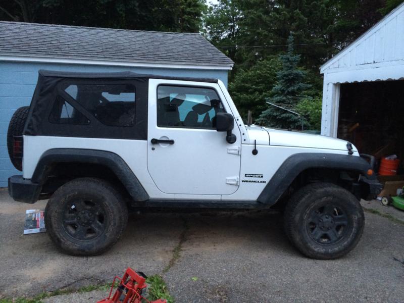

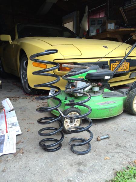

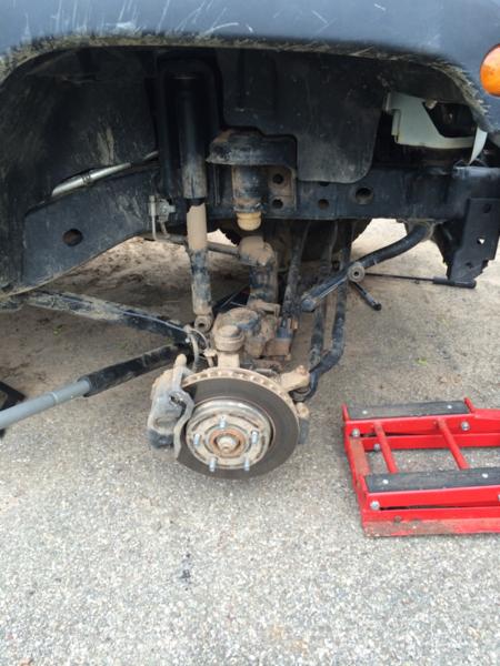

Well just finished! Am tired!! Did it alone- crappy no tools made things tougher. The front shock top mount was almost impossible to remove- rust had seized it a bit got em after no exaggeration an hour of exhaustion.
I gained 2 5/8" !! Better than I expected pretty damn good haha/ that's with just a steel front bumper no winch.

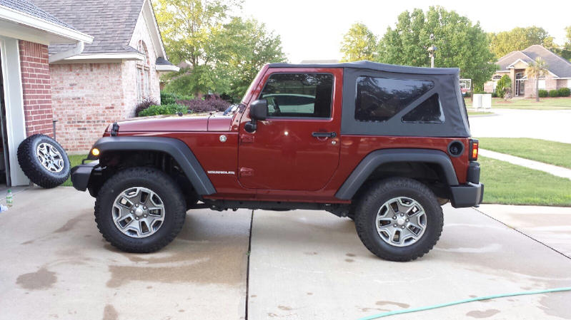

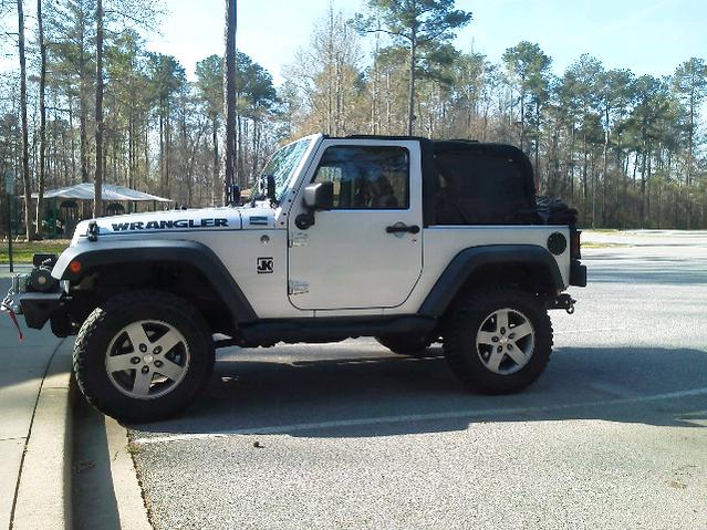

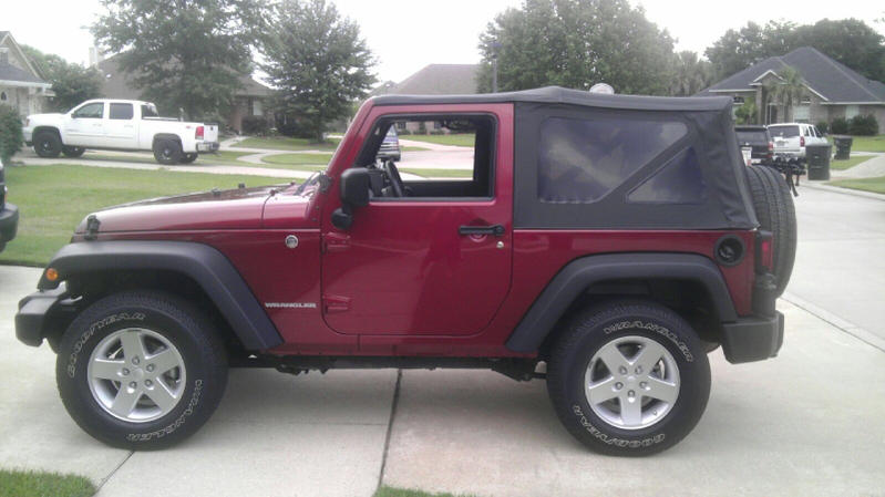

Turned out nice! Here is mine before and after.
Stock
With Rubi wheels and tires
Complete

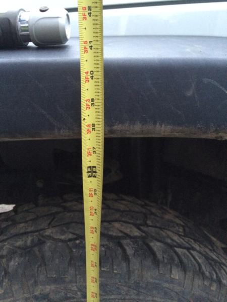

I just installed the 10a springs(19/60) and shocks on my '10 2dr and got about almost 3" lift. I had sag from the old springs for sure, but I measured before at 31.5 and after install i was at 34.5. After driving and letting everything "settle" i measured again at just under 34.5".
