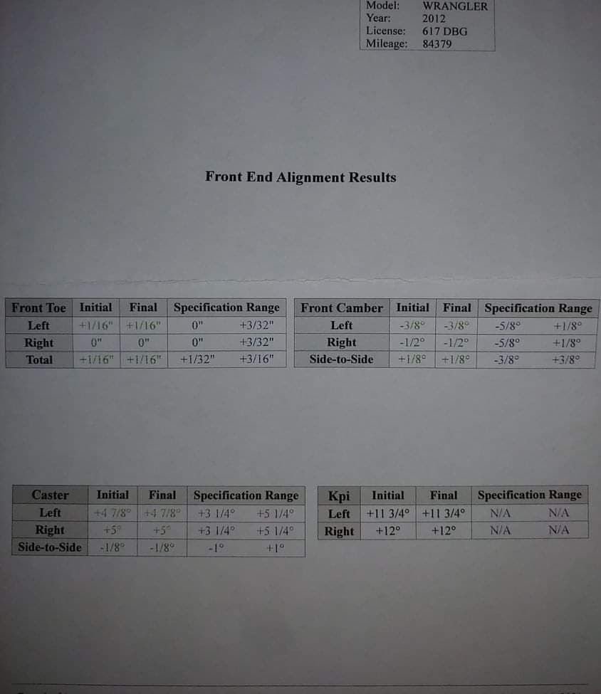

I've gotten my 2012 JKU pretty well dialed in. After installing front and rear adjustable track bars, control arm correction brackets, new shocks and tires, fresh swaybar end links, and a beefier swaybar, she's riding pretty nicely.
There's still a drift/pull to the right with hands loose or off the wheel. I checked the thrust angle on the axles and they're only 0.05° off, about 1/16", so I'm not sure how much that's contributing. Nothing on the alignment sheet really screams at me, so I'd love to get some input from you alignment whisperers out there!

Drifting to the right is normal, manufactory set it up this way. My guess is if you fall asleep you will drift off the road rather than into oncoming traffic.
