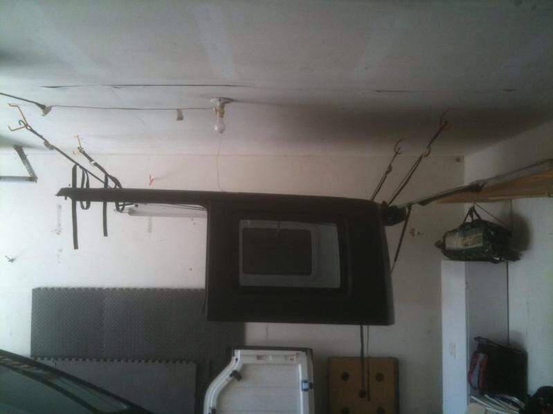

Four bike hooks and four buckle straps. I've been using this setup for 5 years and hasn't failed me yet. Just make sure you get the hooks into studs.
