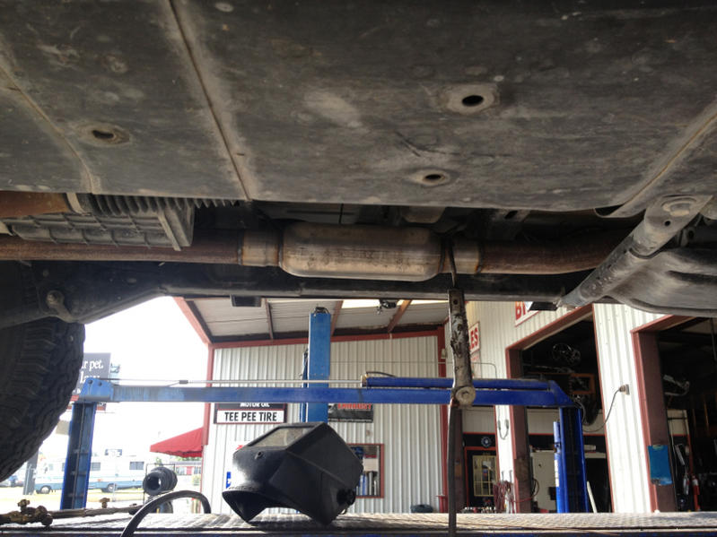

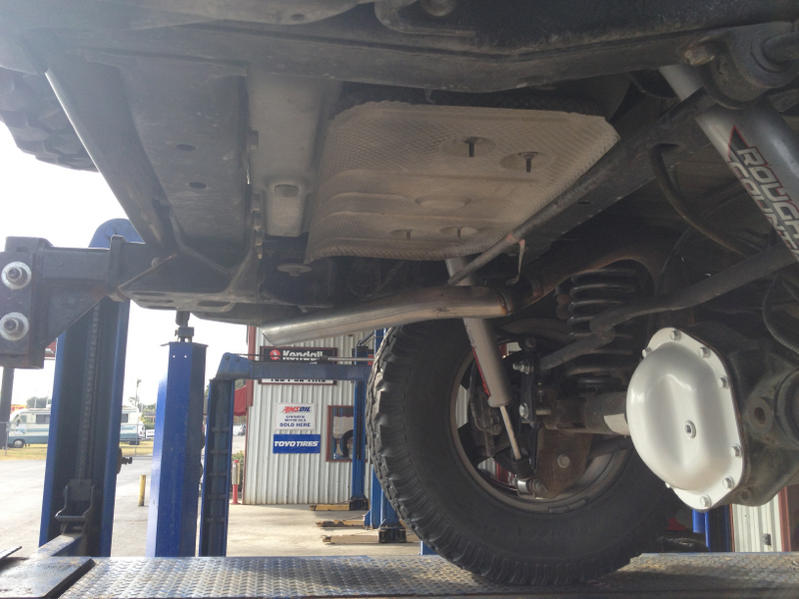

As long as you are not worried about your warranty you should be fine using stock pipe. If your like me and keep all your stock parts you change you might want to reconsider. I had a shop make men's completely new system including a resonator delete with a flowmaster super 44 for under 200 and it includes a lifetime warranty and all stainless steel pipe.
Had mine done for$60 sounds nice looks even better.
