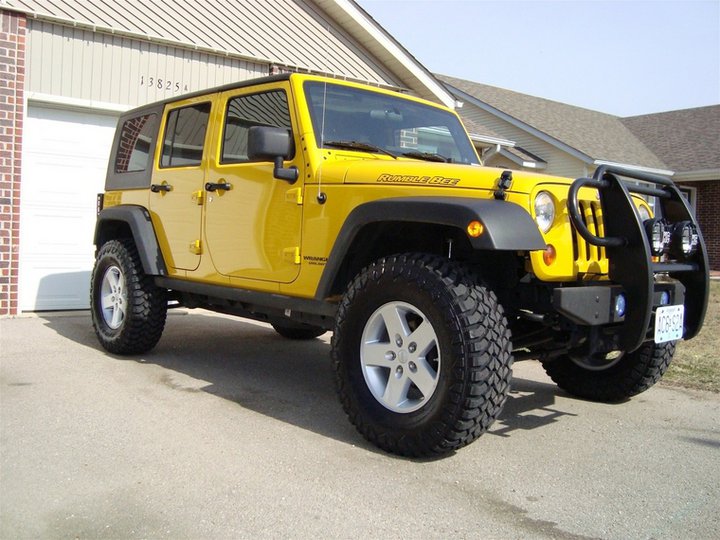

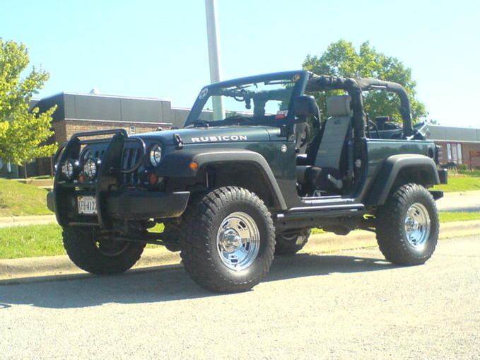

It's a good guard. I had it on my '07 and 08. The lower part was a pain to bolt on, the upper brackets were pretty easy. It saved my grille and hood a couple times from some branches.

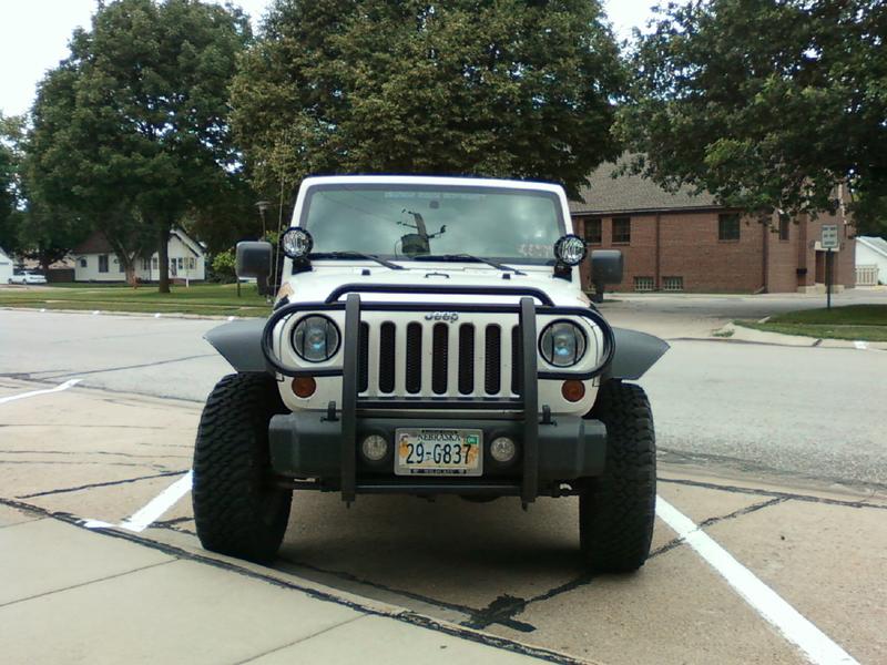

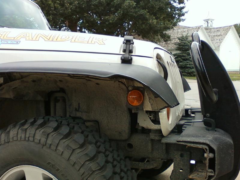

I put this on my jeep for the very reason of deer. I live in a part of nebraska with a pretty high number of deer. Its fairly sturdy. Not heavy at all. PITA to install tho. my only complaints are-
1: the top brackets push back into the grill, i have to little divets where the paint is worn away. the whole assemble has about a 1/4inch of play.
2: when taking my jeep on trails, i lose my approach angle. the bottom brackets stick about 2-3 inches below the frame and tend to hit rocks. hangs me up quite a bit.
If your looking for a cheap way to protect your jeep from deer, this would work fairly decent. If you plan to do any rock crawling though, try looking for something else.
